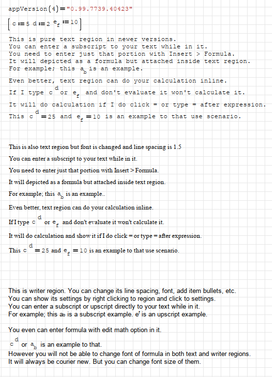

Hello to everybody,
I am new with this software. I want to know about the possibility to define subscripts in text, not in formulas. Aditionally, I want to do are class notes for the students: initially, I want to define the theory and then some examples about that. Is it possible to write formulas and that they won't be calculated?

Maybe usage of text region as it is shown in example below can satisfy your needs.
If you install Writer Region plugin you will find out it has more capabilities.
