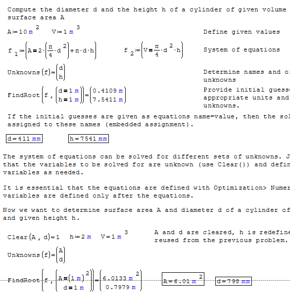

I cannot reproduce the solver problem in the screencast. The default precision is 4 decimal places, whatever that means: 4 significant digits (would be the preferred and only unit-independent variant) or an epsilon setting of 10^-4.

About the FindRoot() in your example. I do not know why I get different result (Win7 64bit), but I messed up with different Nonlinear Solvers by Davide (some of them were totally unofficial). I think we should not worry about this at the moment. We will see when Davide announce the official version.

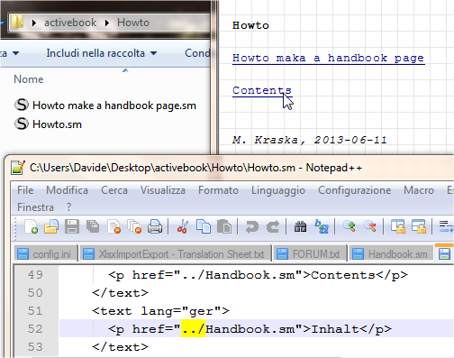

Hi Martin
First of all, wonderful job, that's the most closer attempt to a SMath's embedded guide
2nd (@Andrey) I think that an additional attribute could be added to enable/disable an "Handbook mode"; f.e. that option can enable the toolbar that you have provided for the reference book
3rd (@Martin) IMHO, as for now, a tree-based structure for the files is needed (at least a simple double level structure) to make the Handbook file easier to find (I've attached a couple of screenshots); in the other hand if Andrey found a better way to handle SMath's handbooks, an additional attribute "Handbook root" applied to the main file would be enough
Strange, this is not happening on my Win7 32bit

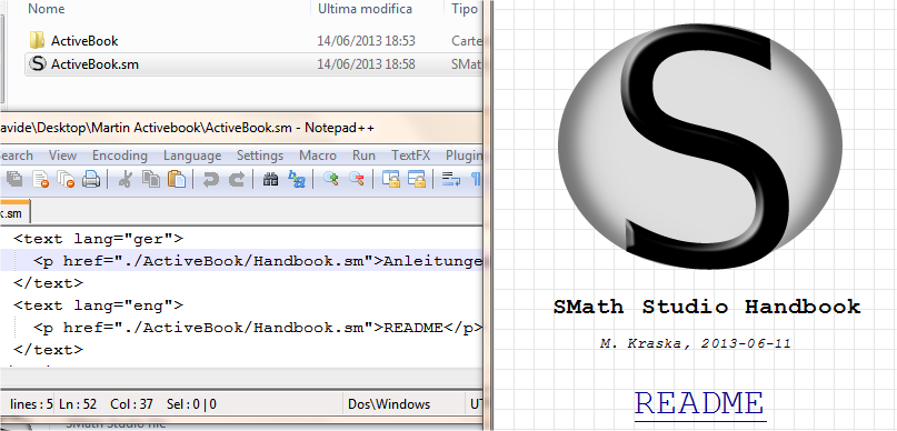

BTW a 3rd way could be to add all the worksheets inside a folder and to add an additional "cover" worksheet outside this folder with a link to the HandBook.sm; this not require many efforts and help to have a clear front-end.
I've seen now your video, I do not understand from where the initial results come...
