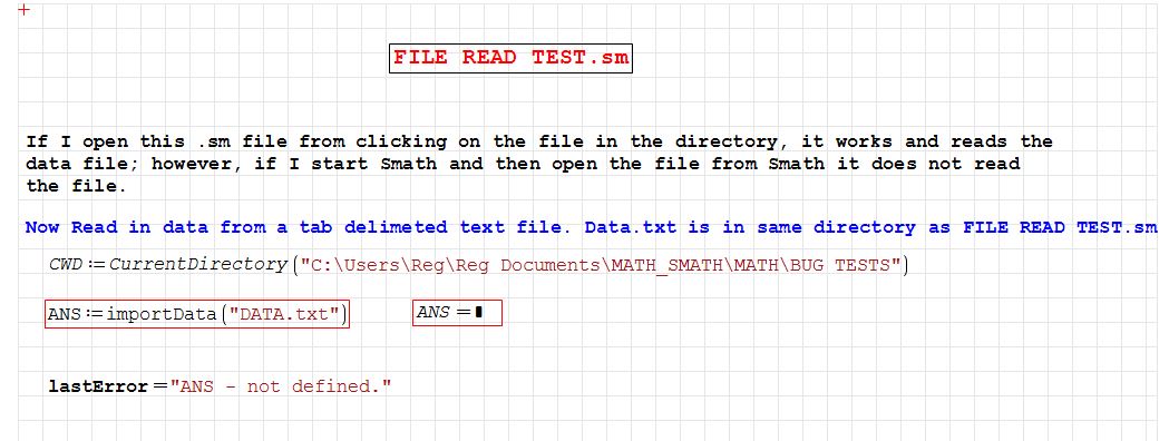

If this has been previously noted, I apologize.
If I open this .sm file from clicking on the file in the directory, it works and reads the
data file; however, if I start Smath and then open the file from Smath it does not read
the file.
#2 Опубликовано: 26.02.2019 20:56:43
Confirmed, thank you!

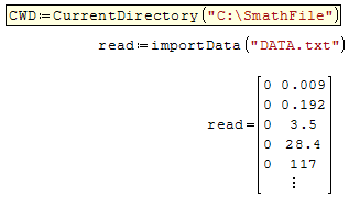

#3 Опубликовано: 26.02.2019 22:50:48
data file; however, if I start Smath and then open the file from Smath it does not read the file.
Something you are not going correct:
1. Copy the DATA from your download
2. Paste in your Smath file directory
3. close session ... open Smath session
4. address the CWD:=
5 read back

#7 Опубликовано: 27.02.2019 00:18:08
RegCurry
RegCurry
0 сообщений из 57 понравились пользователям.
Still does not work for my file structure. Don't think I will change my file structure for this one program.
#8 Опубликовано: 27.02.2019 00:25:40
Should have said, my path is very long and I have had trouble copying the path from the windows folder and pasting into the any Smath argument.
CWD = Current Working Directory.
1. In your C:\ ... create the SmathFile directory.
2. From your Windows "Download"
3. Copy DATA... 4. Paste in your Smathfile from where you read.
Tip: once you can read [I suggested 'read']
Explode read in expanded vector [read]=
Copy the data in a new assigned vector ...
now you can plot. I played a bit from direct reading
but Smath complained and crashed the work sheet.
That's why you have to isolate the vector,
Then you will play at will with that monkey branching.

#10 Опубликовано: 27.02.2019 01:39:31
now you can plot.
... like this:
