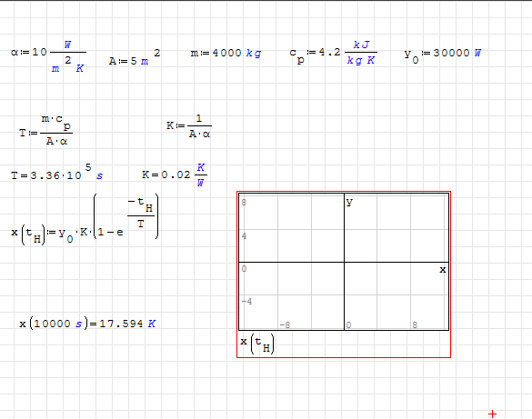

I made several attempts to draw a function as 2D plot. Somehow I have always bad luck. Can someone tell me what I must do to succeed?

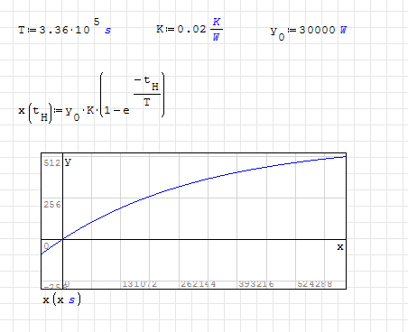

The variable you want to use as abscissa in the plot must be called x (when used in the placeholder). So you have to write x(x*'s).
More informations in the wiki: Graphs

Thank you for your support. Now I am able to plot the function.
