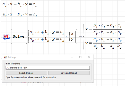

Such as this
a.1*x+b.1*y≡c.1
a.2*x+b.2*y≡c.2
How to get symbolic results for x and y

Hi, It's posible whith Maxima Plugin

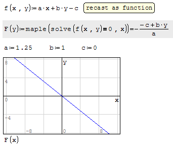

... get lot more from maple companion.
ODE Symbolic Verhulst [Logistic].sm (25,55 КиБ) скачан 1072 раз(а).

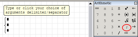

How to input more than 2 equations in Solve after curly brace?
There are only 2 placeholders by default.
#6 Опубликовано: 13.02.2022 10:41:49
Did you mean in Solve within curly brace ?
Maybe from the f(x) menu ...
FindRoots(2) ... FindRoots(3) ... FindRoots(4)

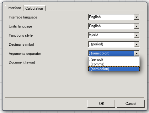

#9 Опубликовано: 13.02.2022 11:27:27
This includes expanding vectors, adding new arguments to functions, etc.
netsonicyxf 13.02.2022 11:28:00
