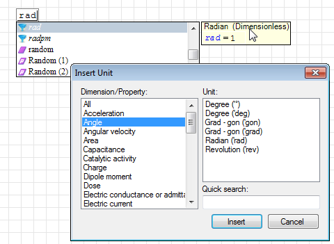

I try to adjust the units of the portable distribution by a custom xml file in the entries folder.

Part of this can be mitigated by re-declaring the units in a custom xml file.
However, not really. The selector box shows the new category, but the dynamic assistant does not.
![2017-03-01 18_25_14-SMath Studio 0.98.6179 - [Page1_].png](/ru-RU/files/Download/5Qy35d/2017-03-01-18_25_14-SMath-Studio-0.98.6179---[Page1_].png)

However, all three units (radpm, rpm, rph) are offered under frequency in the selector box and labeled as frequency in the dynamic help. This is wrong and doesn't really help in the frequent discussions on frequency vs angular velocity.
<units>
<property dimension="613" title="Angle" lang:ger="Winkel">
<add factor="1" system="All" id="294">
<synonym name="rad" lang:rus="рад" />
</add>
