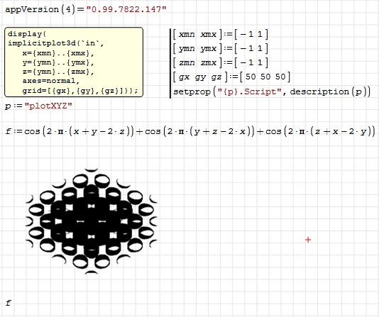

Hi. You can try this:
maple_implicitplot3d.sm (7,32 КиБ) скачан 1153 раз(а).
Also, can read more about maple complement here.
