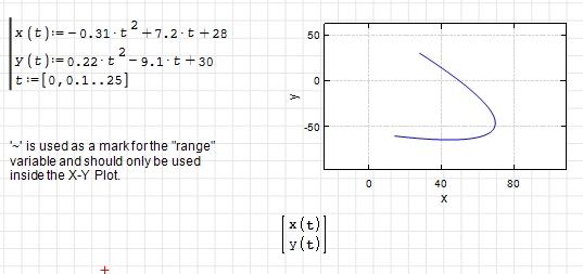

#2 Опубликовано: 17.10.2022 16:16:22
Is it possible to draw such a graph.
Yes it is possible.
Here is your request.
Graphs_1.sm (4,68 КиБ) скачан 1233 раз(а).

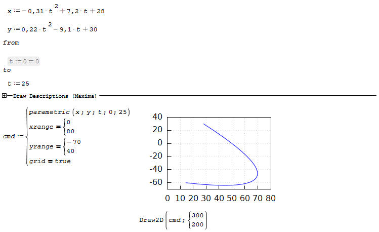

#7 Опубликовано: 19.10.2022 05:17:14
The Maxima plugin provides plotting functions, among them parametric plots. For details look for "kraska smath handbuch".
Note that there seems to be a png export glitch. The region t:=25 is disabled in the sheet but not grayed out in the export (image below). The parameter variable obviously must be undefined, otherwise the x and y expressions are just numbers.
para.sm (137,85 КиБ) скачан 1269 раз(а).
