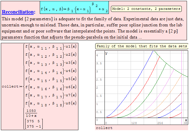

In short: Smath recovers your TESLA [1959].
Multisim is left to be coded to read either maths or Smath graphs
Genfit Minimize TESLA RECONCILIATION.sm (389,53 КиБ) скачан 1084 раз(а).

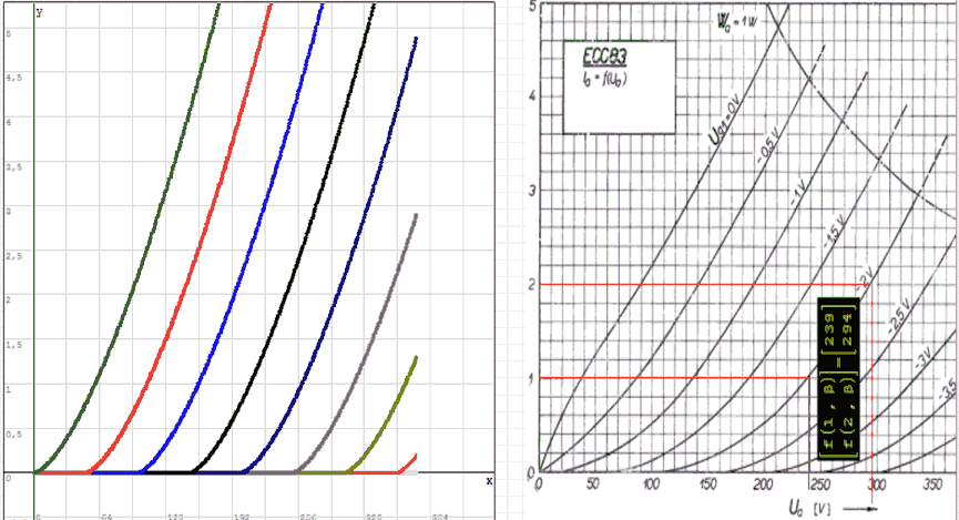

HOLA Ola_Nicolas!!!
What I did, was simply find the equation that represents each curve
of the given graph. The functions are continuous, but when representing
a polynomial of 4 degree, they are unstable outside the specified ranges.
On the other hand, doing a little research, I found that the curves of
the TESLA graph were constructed with the equations of Scott Reynolds
and Marshall Leachfon, or with the improved equations of Normal L. Koren.
The plate current equation for triodes is
IP = (EG + EP /� )^3/2 / kG1 for (EG + EP /� > = 0
= 0 otherwise.
The plate current equation for pentodes is
IP = (2 / kG1p) (EG + EG2 /� )^3/2 arctan (EP / kV for EG + EG2 /� > = 0
= 0 otherwise.
� is the amplification factor
Unfortunately, these equations also contain a decision.
Here I leave the information link, which I hope will be of interest and help to you.
http://www.normankoren.com/Audio/Tubemodspice_article.html#Platecurves
Here is a small attempt to graph the curves with the formulas indicated above.
Tesla_CBG_R1.sm (137,44 КиБ) скачан 1086 раз(а).

... this model should solve all curves.
It solves/iterates nicely for this particular data set.
f(x,β) recovers from the reduced solving procedure.
Genfit Minimze Tesla.sm (45,6 КиБ) скачан 1126 раз(а).

Ok ... Savant gadgets are just gadgets, proof: the one you have used has muffed
your lab test. L. Koren equation is phenomenological as it says. Unfortunately,
experimental data are not exactly reproducible. Nothing in the circuitry is
reproducible not even the triode/pentode ... think of similar physics wrt T/C
T/C = Thermocouples. In short, the Creator was short of fully understanding what
He was creating.
Your complex attempted formulation does not speak to me.
The attached proposal fits your data sets based on 2 parameters and 2 fixed constants.
The constants are the initials X, Y of each experiment. It needs only two parameters
for each experiment. The model function is not suitable for auto-iterate ... peanut
work to calculate trial/error.
If possible, it would be interesting your collect ~ 20 points, raw ... as measured
with good equipment. No processing, no spline curve junction.
Salut Nicolas, will read you soon ... Jean
Genfit Minimize Tesla(5) Copy.sm (207,62 КиБ) скачан 1144 раз(а).
... easy to trick the argument (x+ε)
Now, with a single set of initial β it iterates
and fits all data sets !
Genfit Minimize Tesla(5) Auto_Iterate.sm (211,37 КиБ) скачан 1160 раз(а).

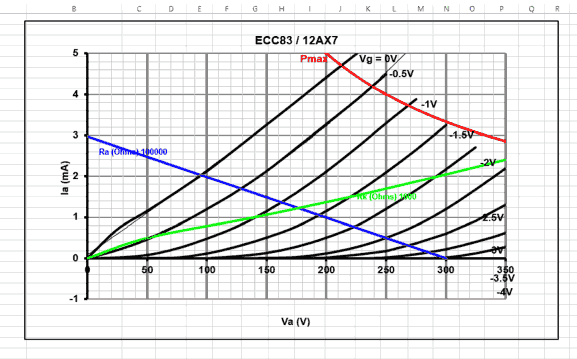

I found this page that I hope will be useful:
http://www.valvewizard.co.uk/links.html
It contains a file in excel for the calculation of the triodes graphs
LoadLinePlotter.xls (817 КиБ) скачан 695 раз(а).
Thanks Carlos, interesting visit.
