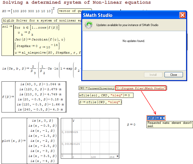

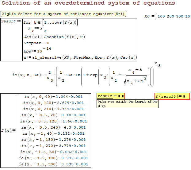

Hello.
However, AlgLib Solver works faster and depends little on X0 matrix.See # 29
https://en.smath.info/forum/yaf_topics32_Extensions.aspx
Overdetermined.sm (15,26 КиБ) скачан 1205 раз(а).
I'm sorry, but again I have problems using this type of algorithm - see the attached image.

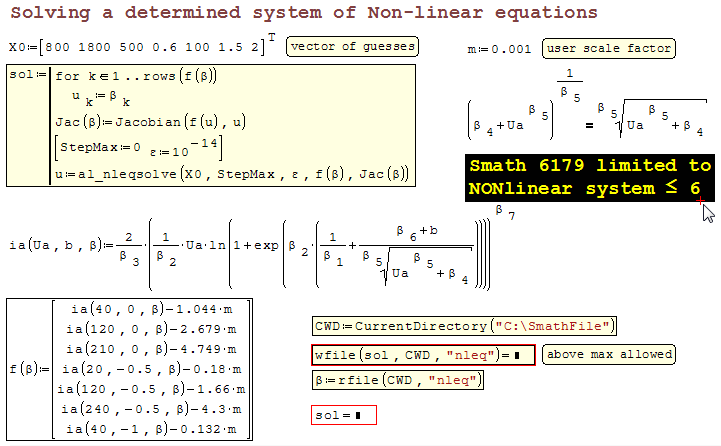

#125 Опубликовано: 26.07.2018 17:30:25
Just open and run my latest work sheet, posted today.
If you run 6671, your al_nleqsolve(,,,) needs be updated as well.
"Out of index..." => too many equalities wrt parameters.
#126 Опубликовано: 28.07.2018 03:56:42
Nicolae Olaru
Nicolae Olaru
1 сообщений из 115 понравились пользователям.
Hello.
There are no updates for my 6671. For my SMath directory, I still have errors.
Nicolas
#127 Опубликовано: 28.07.2018 08:07:01
My Smath is as well in C:\Program
But all the work sheets are in C:\Smath 6179
Where you have all your Smath work sheets, add a New Folder,
name it "SmathFile" [typical or else]
address CWD:=CurrentDirectory(......)
#128 Опубликовано: 28.07.2018 14:28:06
Nicolae Olaru
Nicolae Olaru
Hello.
What do you call SMath Worksheet? I searched for these two words across my computer and I have no results. Is there a folder where you store all SMath files? I do not have a single folder for this purpose. I store sm files for each domain and I therefore have a whole library of sm files stored in folders with different names. That's why I do not store these folders in the C partition of the system, but in a D partition structured by domains of interest.
... Is OK. I have entered the address of one of these folders, where I stored the examples from Ber7. I see it works. Perhaps that address should be the folder where the file is stored.
Nicolas.

#130 Опубликовано: 28.07.2018 17:04:04
When you click on the Samth icon from the task bar, what does it do ?
It opens a work sheet of the number pages needed to complete the project.
All my work sheets are stored in a single folder C:\Smath 6179 [about 1600]
A global single file where to store/transit some reference modules, transit
some data to avoid re-computation, store images ...etc is all what I need
and this file is in C:\SmathFile ... from CWD:= CurrentDirectory("C:\SmathFile")
then, I address whatever can be filed for purpose.
My C:\Smath6179 contains 1554 work sheets, all categorized mnemonic,
easy to retrieve, for instance: Solve is a large category [101 work sheets].
Much easier to glance top to bottom through 1554 than having about 50 different
folders according to projects categories.
In < 2 sec, I retrieve any of my specific project [Instrumentation],
just the time to scan down 101 items.
BTW, you don't have to spool to file 'sol' ... just = but wise to
copy/paste in β:= as an independent/isolate vector.
Cheers

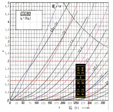

#131 Опубликовано: 01.08.2018 23:45:39
CBG
CBG
I believe that the function:
does not exactly represent the values of the Triode ECC83 graph (Tesla Graph).
Here is a comparison:
Levenberg_Marquardt_Code_CBG_Jean_Tesla_Test.sm (1,45 МиБ) скачан 1271 раз(а).
Carlos
#132 Опубликовано: 02.08.2018 11:27:15
Quite right, Carlos.
The proposed function fails to fit the data sets.
Tentatively, al_nleqsolve and Levenberg-Marquardt do find a set of parameters.
As applied to fit all curves, then do not fit .
If there is an eventual compatibility, the problem is to initialize.
I tried quite a few with the most robust al_nleqsolve, not to avail.
Of all the models that were tried, I have conserved the 2 constants + 2 parameters
Genfit Minimize Tesla(5) Auto_Iterate
No matter how much maths one can invent, it is not true an invented 6 parameters
will fit 8 data sets each having his own set of 2 parameters. If such miraculous
maths would exist, I bet it would have been explored/exploited in Mathcad/Mathsoft.
Solve al_nleqsolve Ber7_Nicolas Copy.sm (55,14 КиБ) скачан 1200 раз(а).
Genfit Minimize Tesla(5) Auto_Iterate.sm (238,11 КиБ) скачан 1253 раз(а).
Page2 Tesla.sm (178,4 КиБ) скачан 1436 раз(а).
#133 Опубликовано: 03.08.2018 15:39:00
Nicolae Olaru
Nicolae Olaru
Hello.
You're right Carlos. In fact, this was the first challenge, which was actually missed. Jean Giraud is not right. MatCAD has solved the problem, so mathematical tools exist. Proof is the chart I brought in the first post. Perhaps they will be in SMath in a while too. Until then, I accepted the second challenge, that of studying in detail the current mathematical tools that SMath puts at my disposal. From this point of view, it was a very useful experience. I thank you all for your help.
Nicolas.
#134 Опубликовано: 03.08.2018 16:25:33
OK, Nicolas ... then plot the fitted family of results over the data sets.
Or, attach enough information so that I can spare some times in Mathcad 11.
This is paramount wrt Smath designers, especially from so much efforts.
Cheers Nicolas ... Jean
