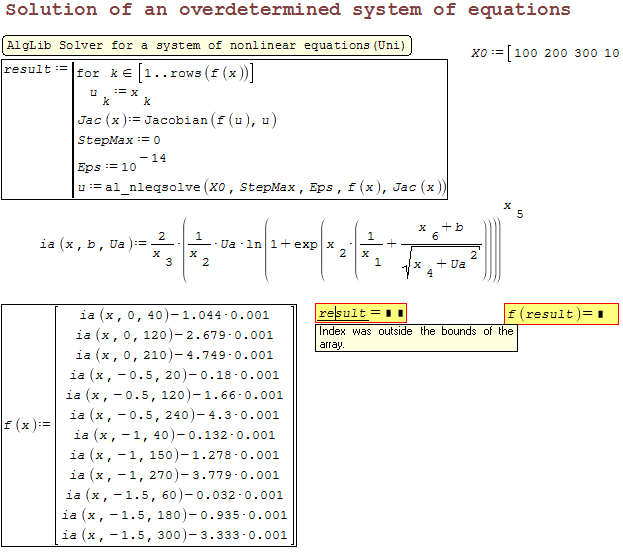

WroteHowever, AlgLib Solver works faster and depends little on X0 matrix.See # 29
https://en.smath.info/forum/yaf_topics32_Extensions.aspx
Overdetermined.sm (15.26 KiB) downloaded 1205 time(s).

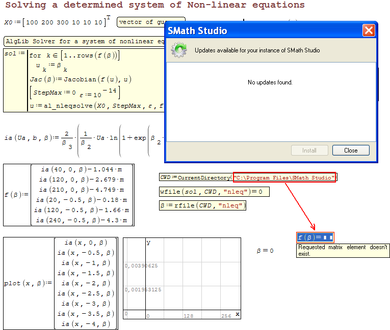

I'm sorry, but again I have problems using this type of algorithm - see the attached image.
WroteI'm sorry, but again I have problems using this type of algorithm - see the attached image.

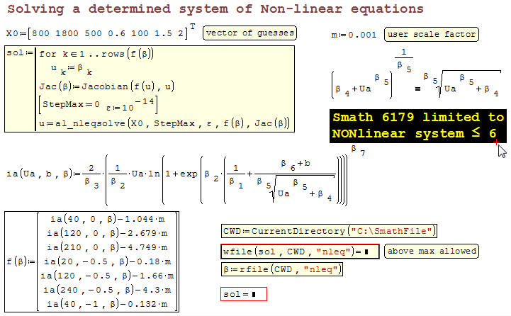

Just open and run my latest work sheet, posted today.
If you run 6671, your al_nleqsolve(,,,) needs be updated as well.
"Out of index..." => too many equalities wrt parameters.
WroteThere are no updates for my 6671. For my SMath directory, I still have errors.
My Smath is as well in C:\Program
But all the work sheets are in C:\Smath 6179
Where you have all your Smath work sheets, add a New Folder,
name it "SmathFile" [typical or else]
address CWD:=CurrentDirectory(......)
What do you call SMath Worksheet? I searched for these two words across my computer and I have no results. Is there a folder where you store all SMath files? I do not have a single folder for this purpose. I store sm files for each domain and I therefore have a whole library of sm files stored in folders with different names. That's why I do not store these folders in the C partition of the system, but in a D partition structured by domains of interest.
... Is OK. I have entered the address of one of these folders, where I stored the examples from Ber7. I see it works. Perhaps that address should be the folder where the file is stored.

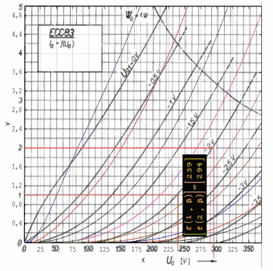

does not exactly represent the values of the Triode ECC83 graph (Tesla Graph).
Here is a comparison:
Levenberg_Marquardt_Code_CBG_Jean_Tesla_Test.sm (1.45 MiB) downloaded 1271 time(s).
Carlos

You're right Carlos. In fact, this was the first challenge, which was actually missed. Jean Giraud is not right. MatCAD has solved the problem, so mathematical tools exist. Proof is the chart I brought in the first post. Perhaps they will be in SMath in a while too. Until then, I accepted the second challenge, that of studying in detail the current mathematical tools that SMath puts at my disposal. From this point of view, it was a very useful experience. I thank you all for your help.
Nicolas.

WroteThe values of beta4 and beta5strongly depend on vector of guesses
The reformated model is now robust.
The native beta's fit exceptionally well the first data set !
Slightly modified for the remaining data sets.
The Mathcad coefficients are given as well for comparing.
Puzzling why the same coefficients produced crappy Mathcad plots ?
All in all, a very interesting project exploiting exp(,) reflexive.
Smath solves decently this 7 parameters project.
Thanks Collabs contributors.
Solve al_nleqsolve Ber7_Nicolas [6179] READ 1rst.sm (73.95 KiB) downloaded 1013 time(s).
