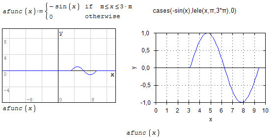

The sample code shows what works and what doesn't. I think the issue is in zed_graph as 2D works. It stops working when the if is added to the function zedgraph example.sm (151,36 КиБ) скачан 1367 раз(а).
#2 Опубликовано: 21.12.2019 18:09:32
Seems that Zedgraph can't handle if(). It also fails at non-numeric or undefined values.
A workaround for if() is the use of cases() from Customfunctions plugin. It converts into a boolean expression, which can be handled by Zedgraph.
Suppressing parts of a curve by making it undefined doesn't work. You just can set it to zero.
I am not using Zedgraph. Even setting axes limits requires a lot of scrolling through option trees. XY-Plot is much better in that respect. For log plots I use Maxima Draw regions.
zedgraph%20example_Kr.sm (34,05 КиБ) скачан 1636 раз(а).

#3 Опубликовано: 21.12.2019 18:25:56
charles esson
charles esson
0 сообщений из 9 понравились пользователям.
Thank you for your help.

Hi mkraska
I really like the afunc syntax and I am sorry but Newbie I am. How did you get the if after -sin(x)
#7 Опубликовано: 22.12.2019 05:43:33
charles esson
charles esson
Hi mkraska
worked it out. types in cases; thank
