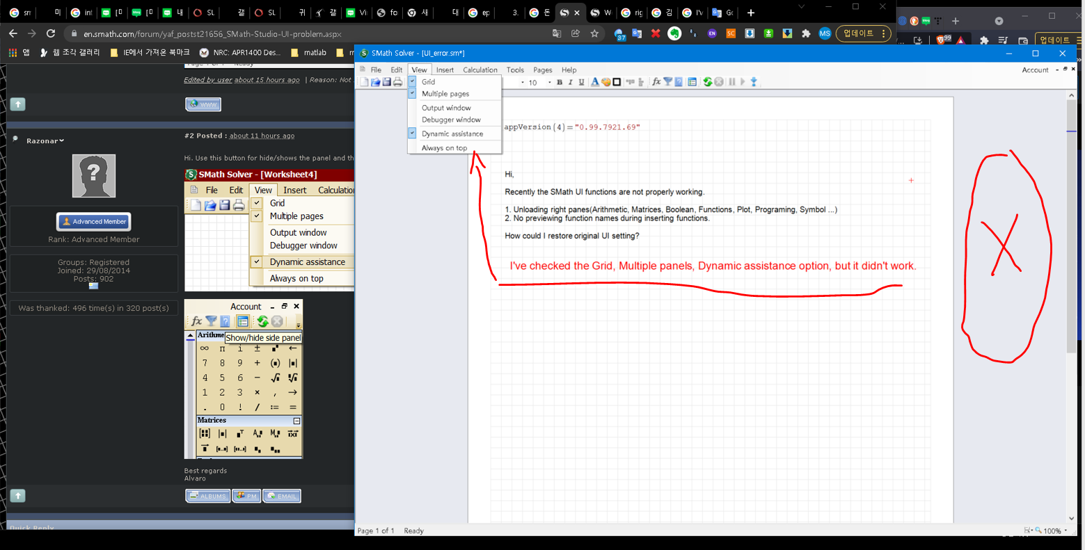

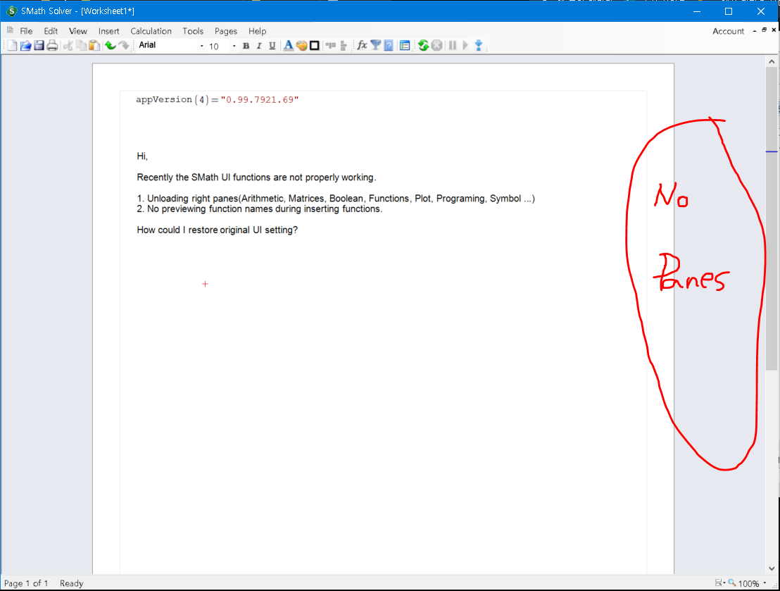

Recently the SMath UI functions are not properly working.
1. Unloading right panes(Arithmetic, Matrices, Boolean, Functions, Plot, Programing, Symbol ...)
2. No previewing function names during inserting functions.
How could I restore original UI setting?

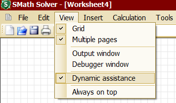

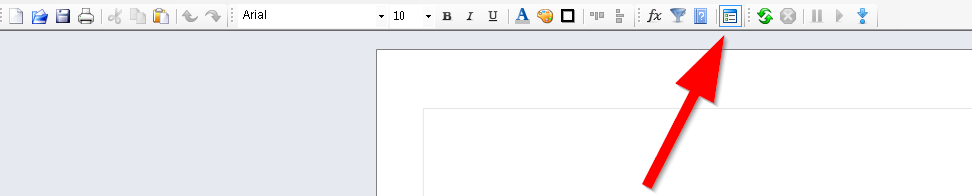

Hi. Use this button for hide/shows the panel and this option for autocompletion (dynamic assistance)

I've tried set the multiple panel & dynamic assistance option, but it didn't work!

have you tried to press the "show/hide side panel" button as suggested by Alvaro (Razonar)? Looks unactivated in both your screenshots.

It works! Everything is fine after click the button!
