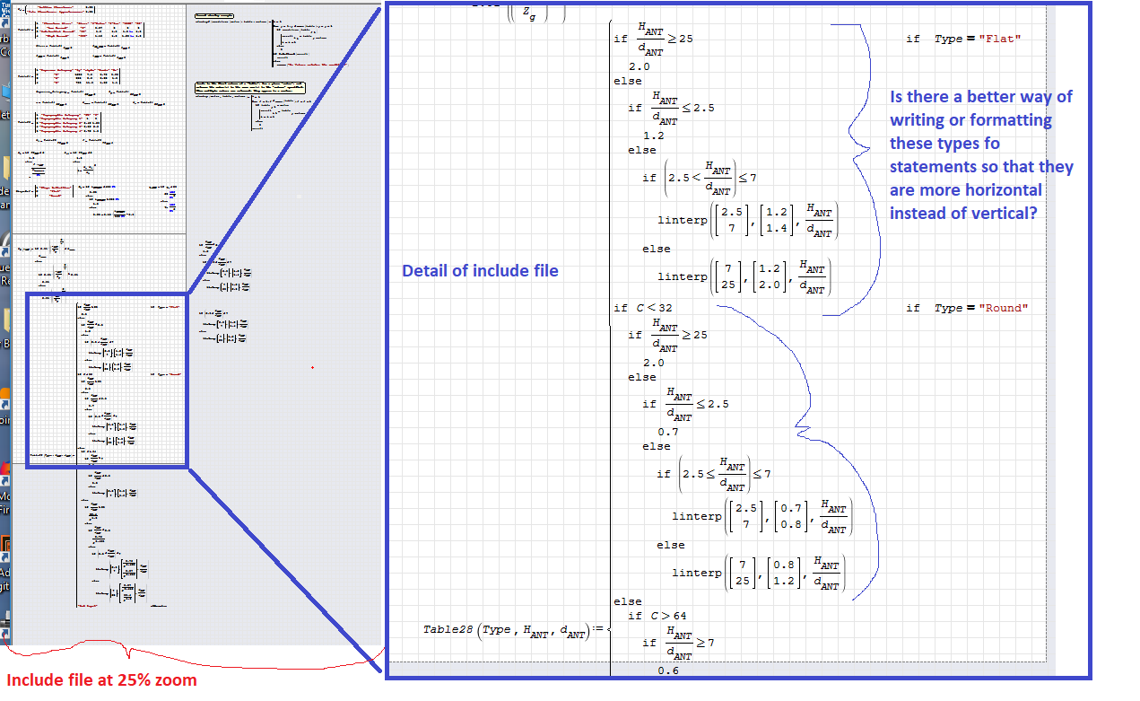

I have an include file with a bunch of functions and variable definitions in it. Within one of my functions is a 'cases' and a bunch of if/thens that makes it REALLY long.
Are better ways to script or format the syntax for something like this? The sheer vertical size of this trips me up sometimes and I need to get my bearigns to navigate it.
Thanks
Dennis

WroteAre better ways to script or format the syntax for something like this ?
For horizontal, use if/otherwise instead of if/else
Open the collapsed area [mapR(x), mapG(x),mapB(x)].

THANK YOU! that will help me make things so much cleaner. I need to take some time to get my head around the way I have it now to clean up.
Question- at the value of say 64, do the sucessive (32≤x)&(x≤64) and (64≤x)&(x≤96) have a conclict? should one of those terms be a less than instead of a less than or equal too operator?

... can't tell w/o the document. On top, you complicate matters
Can't you mange f(x) ... linterp(X,Y,x)
... or part of the document that produces something.
