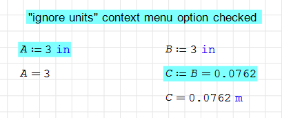

#4 Опубликовано: 23.01.2024 21:18:15
Once you store a variable, everything is converted into base units. To obtain the value for whatever unit, you just divide the variable by that unit.
If you want to keep the info about the original unit, you have to store it in a separate variable.
↑↑↑ This ↑↑↑
Select all the document ... click Ignore units
This works only on on direct definitions.
e.g. A:3'in [with ignore units on A definition] will be stored as 3 (dimensionless), but B:3'in and then C:B [with ignore units on C definition] won't work.
The latter would not help RFreund even if it worked, as data is stored in base units, as mentioned by Martin.
