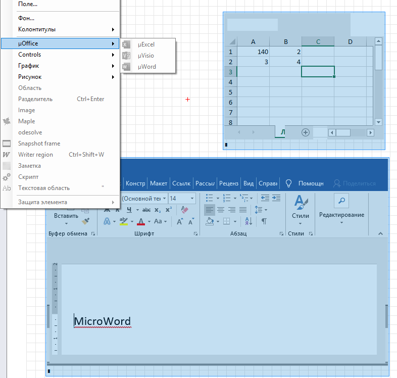

SMath Viewer compatibility mono compatibility Sources
Implementation started.
I don't know how, but I think it is possible to show office documents as images. For editing we can open Word, Excel or Visio as external editors. Documents can be embedded to worksheet.

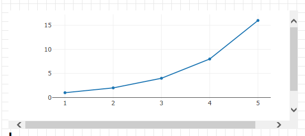

Using this technique it is possible to use the Plotly.js library to draw graphs. Basically, this method allows you to access the usual form, but with limited interaction.

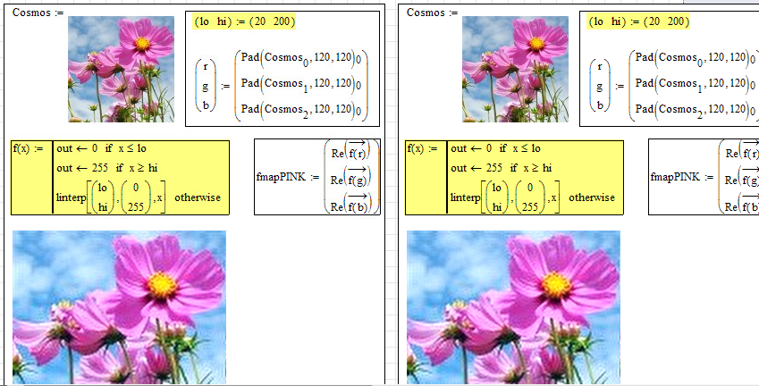

At right is the original in Smath document.
At left is the 100% Adobe, copied/pasted.
#12 Опубликовано: 30.09.2019 11:18:02
Smath document.
PDF Cosmos Test.sm (711,28 КиБ) скачан 1661 раз(а).
After this post, I will re-download check.
#13 Опубликовано: 30.09.2019 11:30:01
... re-download sanity checked confirmed 1/1.

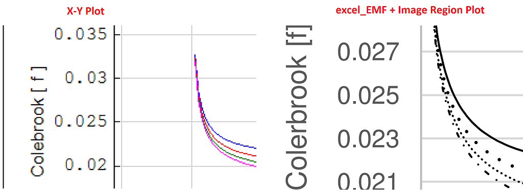

EXCEL I/O plugin will plot regions of excel for you without quality loss by using excel_EMF(#) function
https://en.smath.com/forum/yaf_postst4375_Plugin---EXCEL--2003--I-O-with-recalculation-and-export-to-PNG.aspx
A sample of a Plot produced by combination of excel_EMF function and Image Region inside the SMath workbook.
The example was borrowed from one of the calculations by Jean Giraud.
Note the difference of as-printed quality between X-Y Plot output and excel_EMF output.
This has much more render quality than I expected, actually there is no quality loss. Thank you very much.
