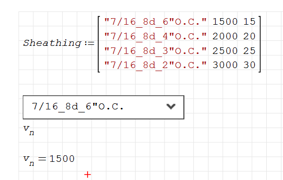

Hello all,
I'm a new member of SMath. Im wondering if it is possible to use combobox to return multiple values from a matrix. Ive attached an image below as an example. If I select 7/16"_8d_6" O.C. I want to have both the 1500 and 15 value return without having to make multiple comboboxes.
Thanks!

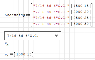

#2 Опубликовано: 10.11.2022 02:45:12
Use a nested matrix.
multicombo.sm (4 КиБ) скачан 77 раз(а).

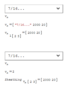

#3 Опубликовано: 10.11.2022 06:40:50
You can also use ranged indices to pick any column you need listed in the order you prefer, without any change in the input matrix.
This is an example using either the item row or the item index

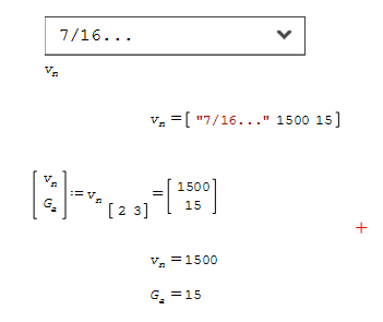

#5 Опубликовано: 11.11.2022 06:40:34
Like this?
#6 Опубликовано: 11.11.2022 14:01:42
Nick Kotichas
Nick Kotichas
Yes that is exactly it.
