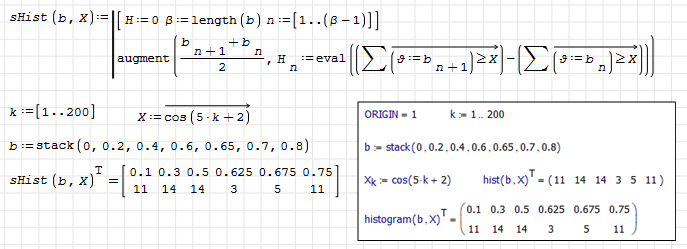

#2 Опубликовано: 10.10.2023 23:36:23
Hi Valery. This function returns the same result as mathcad.
sHist.sm (15,24 КиБ) скачан 1379 раз(а).
Valery Ochkov 11.10.2023 01:53:00, Oscar Campo 11.10.2023 01:24:00

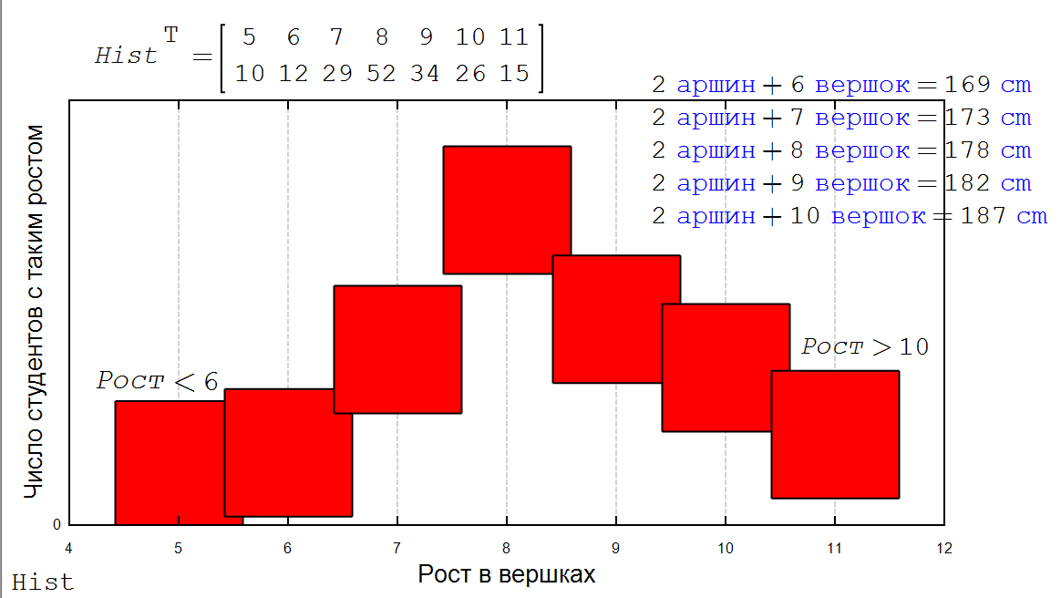

#3 Опубликовано: 11.10.2023 05:25:07
Valery Ochkov
Valery Ochkov
My students histogram

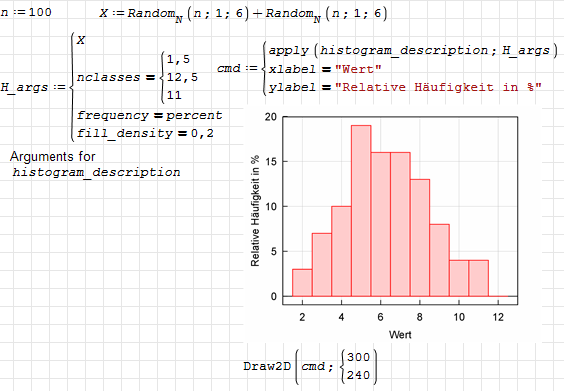

#4 Опубликовано: 11.10.2023 07:42:53
Maxima has a histogram plot function.
Taken from DOI: 10.25933/opus4-2949. The PDF has attached SMath documents.
Valery Ochkov 11.10.2023 20:23:00, Oscar Campo 11.10.2023 09:42:00

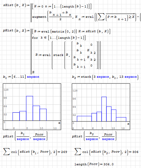

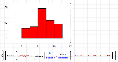

#6 Опубликовано: 11.10.2023 14:43:40
Hi. This version also works with unequally spaced bins.
pHist Mister-Class.sm (61,58 КиБ) скачан 1376 раз(а).
Valery Ochkov 11.10.2023 20:24:00

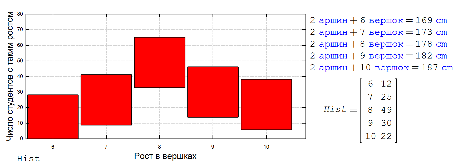

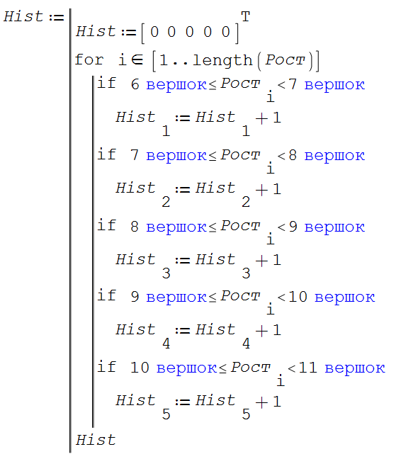

#7 Опубликовано: 12.10.2023 03:08:23
Valery Ochkov
Valery Ochkov
A Live histogram
#8 Опубликовано: 12.10.2023 03:53:13
Valery Ochkov
Valery Ochkov
My KISS Histogram
#9 Опубликовано: 12.10.2023 04:48:09
Hi. You can use the above pHist within XYPlot.
Valery Ochkov 12.10.2023 04:49:00, Oscar Campo 12.10.2023 07:32:00
