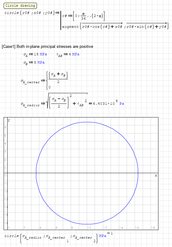

I am trying to plot mohr's circle by following tutorial. I have succeeded to draw circle on the tutorial but not mine.
Could you check my plot?
Thank you.MSS_Failure criterion.sm (8,47 КиБ) скачан 1238 раз(а).

One way to build a graph is to lower the order of large numbers
Primer.sm (8,51 КиБ) скачан 1171 раз(а).
#3 Опубликовано: 13.03.2022 12:32:01
You can make a function to draw circles, for multiple usage on same sheet.
With respect to Ber7, dividing it to MPa will lower the numbers too.
MSS.sm (7,3 КиБ) скачан 1207 раз(а).

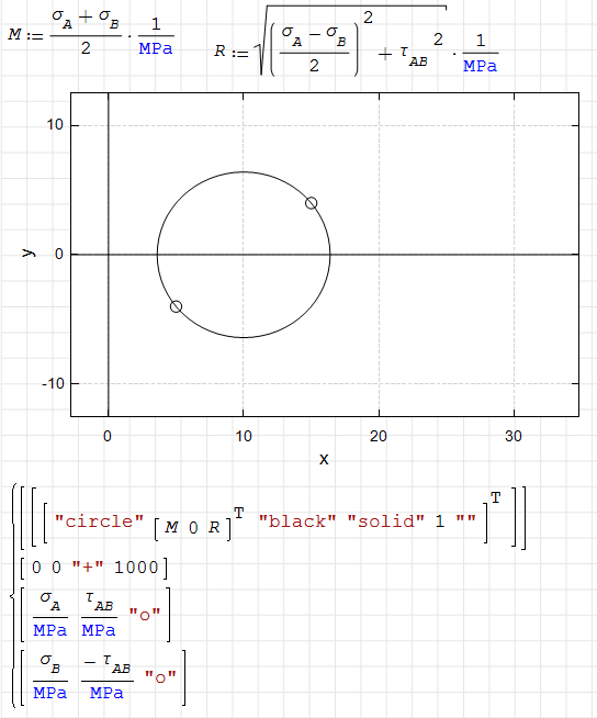

Here is a version with pre-defined geometric object in the XY plot plugin. See Handbuch section 8.3.4.
MSS_Kr.sm (13,86 КиБ) скачан 1208 раз(а).

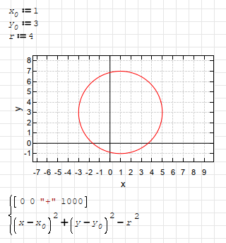

It is much easier to draw circles with X-Y Plot plugin.
circle_xy.sm (5,23 КиБ) скачан 1258 раз(а).
