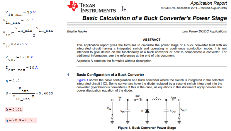

The attached sMath file is an attempt to add "current page" background images. One image per page. It work find for the first two pages, but the third one get skipped and the image appeared on the fourth page.

The goal here is to study technical document by overlaying sMath formula, graph and other elements on top of the background images.
Also attached, the original PDF file and the png images for each pages.

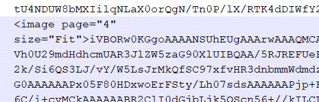

frapuano 14.09.2018 10:33:00
Thank you for this way around. First time I venture into a sm file. I will give it a try.
As for how to do it, just select "Background..." in the "Insert" menu. You will see the background setting window.
As I mention in the post, part of that UI is not obvious. It is hard to tell if you have already selected a "Current page" background. Also the default setting seem to reset itself each time you quit the window. The expected behavior would be to reflect the setting of the current page or the whole document.
Editing the file worked first try. That is great :-) The sm format is pretty simple, nice to see that.

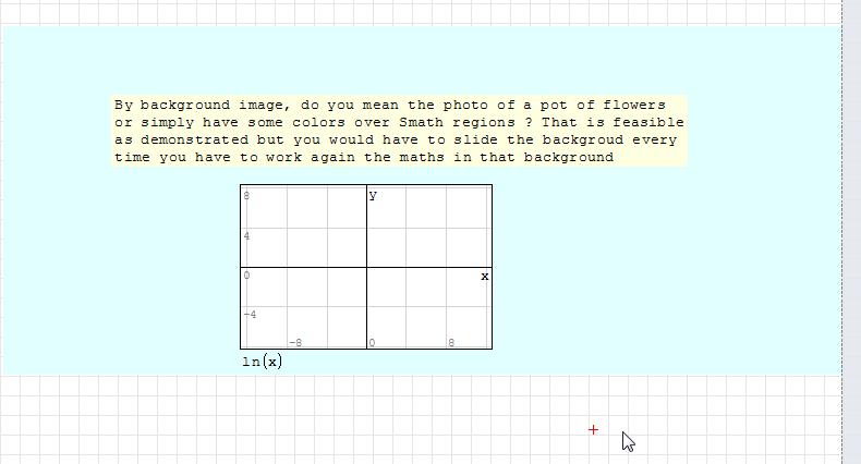

This peanut demo is 2.65 kB. You can have as many regions as you wish,
of any colors out of 1677216 possible colors. The background is OK
by the Print Preview, thus will be saved on virtual *.PDF printer.
This background region is not an imported image, neither an image
created by Smath. Thus, every time you save and at the opening of
the document, Smath complains it can find ... because it is not
really created ... just an incomplete fake. So, on the complain
just click OK to stop Smath suffering.

Hello Jean, if you open the sample file (dc dc buck converter.sm) I posted in the first post, you will see what is the intent here. The background image is an image of a full page from a PDF document.
Guy
Guy
WroteHello Jean, if you open the sample file (dc dc buck converter.sm)
