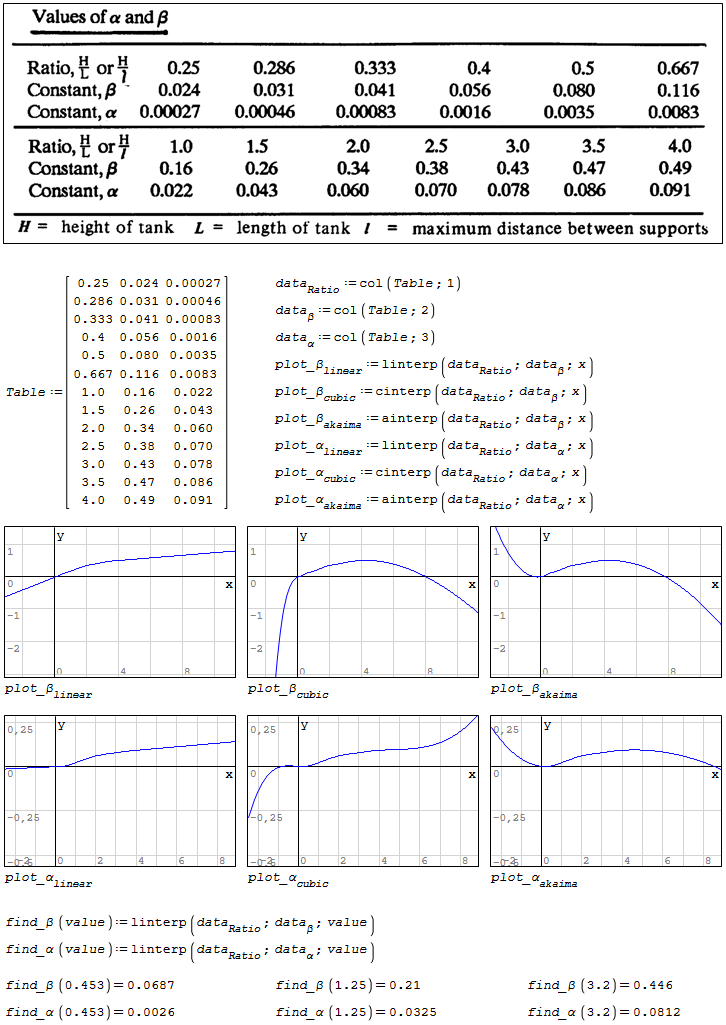

Hi, this is junior school math but what is the best way to obtain any value from a set of data like below? Can this be done on SMath?
Tank Data
The aim is to obtain alpha and beta values from any intermediary values of H/L or H/l.
Thanks,
#2 Опубликовано: 01.12.2022 07:12:38
You can use interpolation functions for that.
There are three different interpolation functions.
Your data seems to be lineear according to values.
Here is a demonstration of interpolation plots.
I also added functions to find β and α.
interpolation.sm (138 КиБ) скачан 73 раз(а).

Possibly, there is a model ▼ function for these two
A tank that has length 'L' has diameter as well.
You can only measure level from [0...1] empty/full.
That's what alpha/beta seem to represent.
If so, the system is the segment approximation.
This problem is solved in Smath 5 decimals [Tema, Perry]
The Smath document ignores the ends. You can roughly add.
Please, acknowledge for eventual completion of the project.
Cheers ... Jean.
Your data seems to be linear according to values.
Thank you, Overlord. Much appreciated.
Tim
Cheers ... Jean.
Thank you, Jean. "L" does not represent diameter. This table is for a rectangular tank design.
Tim
Tim
Obviously the data confirm the tank is not circular.
It may not be pure rectangular either vs deformation.
For + contribution, please don't hesitate.
#8 Опубликовано: 05.01.2023 11:21:53
There is a golden phrase for engineers:
When something is minor effecting overall outcome,
That condition/subject/aspect is negligible.
#9 Опубликовано: 05.01.2023 12:13:50
For contribution, please don't hesitate.
Page2 Table.sm (129 КиБ) скачан 63 раз(а).
