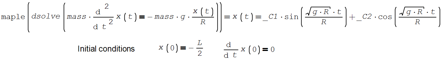

#1 Опубликовано: 01.07.2023 05:56:48
Valery Ochkov
Valery Ochkov
See please one ODE symbolic solution without IC
dsolve.sm (4,93 КиБ) скачан 1408 раз(а).

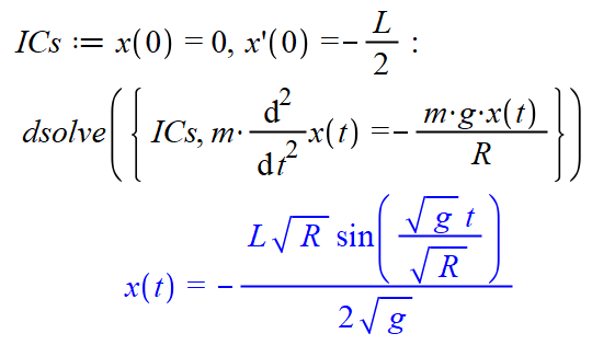

#2 Опубликовано: 01.07.2023 07:55:36
We have it done for exporting formula c/w constants & IC
ODE_Laplace 2nd [Type 3].sm (34,42 КиБ) скачан 1124 раз(а).
Valery Ochkov 01.07.2023 09:20:00
#3 Опубликовано: 01.07.2023 09:20:10
Valery Ochkov
Valery Ochkov
Thanks!
But no way to do so in SMath
#4 Опубликовано: 01.07.2023 10:51:35
Valery Ochkov
Valery Ochkov
Thanks!
"L & m" are missing in dsolve result ?
m is missing in dsolve.

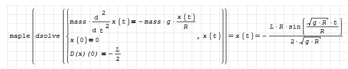

#5 Опубликовано: 01.07.2023 14:48:44
Hi Valery. Use Ctrl+Shift+K for write D(x)(0), which means x'(0)
Valery Ochkov 02.07.2023 04:05:00
#6 Опубликовано: 02.07.2023 04:06:01
Valery Ochkov
Valery Ochkov
Thanks!
dsolve-ICs.sm (10,61 КиБ) скачан 1436 раз(а).

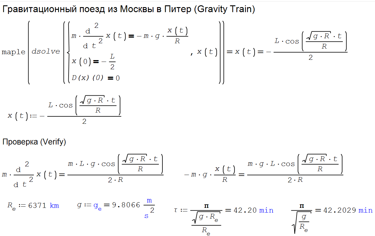

#7 Опубликовано: 03.07.2023 03:43:12
The distance between the cities added.
GravityTrain.sm (31,01 КиБ) скачан 1349 раз(а).
GravityTrain.pdf (233,1 КиБ) скачан 851 раз(а).
Valery Ochkov 03.07.2023 04:18:00

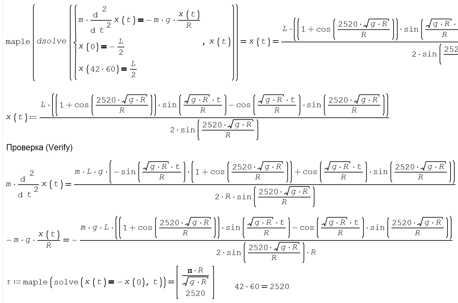

#8 Опубликовано: 03.07.2023 07:30:35
Earth distance companion added.
Sanity check Air Industry.
Angle Vincenty Earth Distance [Mike].sm (49,78 КиБ) скачан 1131 раз(а).
#9 Опубликовано: 04.07.2023 02:14:47
Valery Ochkov
Valery Ochkov
The Boundary problem?
dsolve-Boundary.sm (17,01 КиБ) скачан 1393 раз(а).

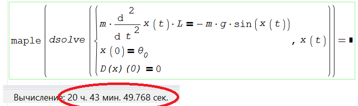

#10 Опубликовано: 04.07.2023 09:30:11
Valery Ochkov
Valery Ochkov
A pendulum
#11 Опубликовано: 04.07.2023 18:53:08
A pendulum ...
The exact solution needs some handwrite work.
Edited: a hard handwrite work. Previous version was wrong.
Click to enlarge
Correct solution -> pendulum v2.sm (13,73 КиБ) скачан 1379 раз(а).
Wrong solution -> pendulum.sm (13,88 КиБ) скачан 1384 раз(а).
