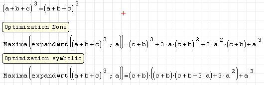

another question:Is it possible to display a symbolic expression a a different form. For example, I have a transfer function in factored form, but I would like it expanded so that I can easily find the various coefficients of s, s^2, ... etc.
Is there a way to do this? thanks
If you have the Maxima plugin up and running then you can use all the possibilities of Maxima. In the given example it is essential to set optimization to "none" in the context menu of the math region. Otherwise SMath tries to re-simplify the result symbolically.
