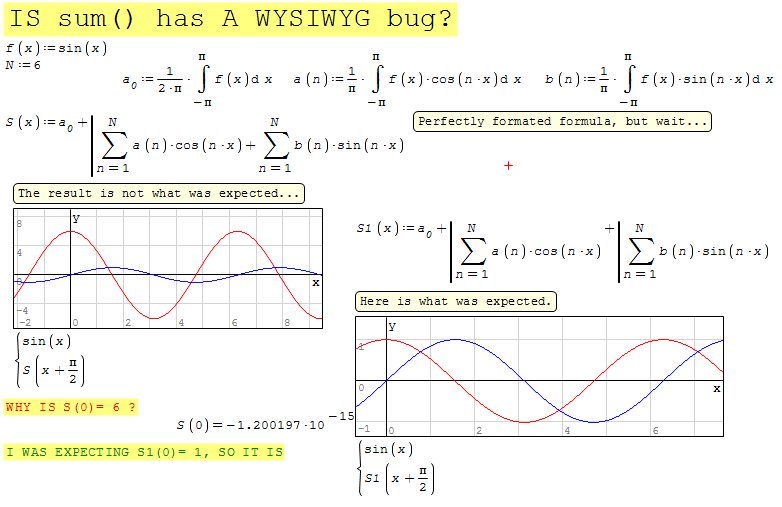

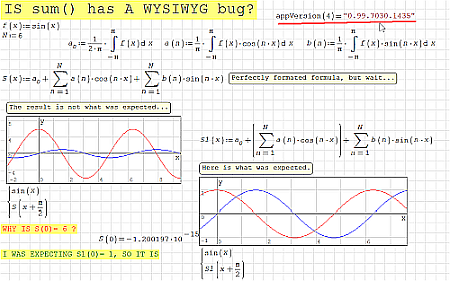

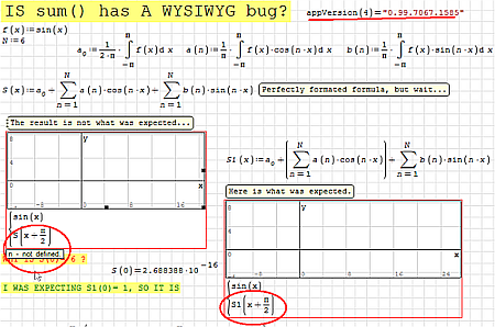

Attached sm file which appeared recently in the forum works in 7030 (stable), but throws errors in 7067 (Beta).
Some times it crashes when trying to evaluate some variables.

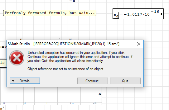

Confirmed,
Sometimes crashed (red cross over the screen) and sometimes didn't.

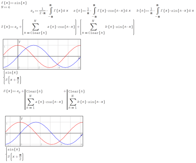

Hi. I don't see a bug here, but some kind of issue handling n. About the WYSIWYG notation, it's well know this kind of difficulties not only in SMath, but in mathcad, maple and mathematica too. About the issue with n it must to be solved using Clear, because n isn't local in the sum.
ISERROR QUESTION MARK_Clean.sm (10,4 КиБ) скачан 1394 раз(а).
sergio 11.05.2019 04:33:00, NDTM Amarasekera 11.05.2019 11:25:00, frapuano 11.05.2019 05:32:00, Radovan Omorjan 11.05.2019 04:51:00
#4 Опубликовано: 11.05.2019 05:04:17
Thank you Alvaro, you are right
This problem with summation will come up here and there. It would be enough to put the summation terms inside a single line environment. This behaviour is present in SMath for quite a while. This is easy to forget, but it should not have crashed in those cases. The problem is how to remember this issue and overcome situations like this one.

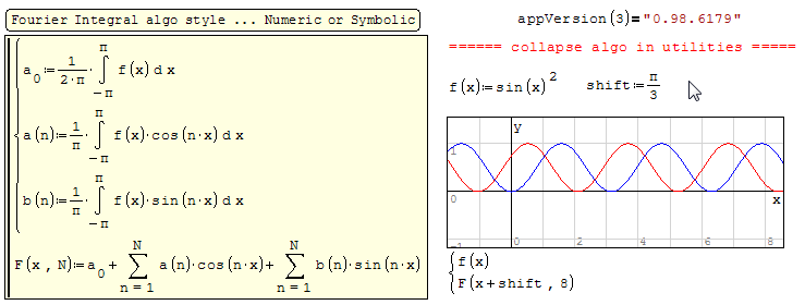

Try this Fourier-algo style.
Fourier Integral Algo Style.sm (7,66 КиБ) скачан 1332 раз(а).

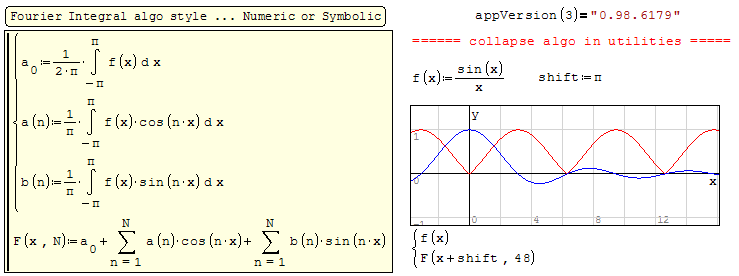

Leave default integral acc 100, only 'N'
Rejects SQRT(x) but takes SQRT|(x)|
Try more ... let us know about your version ... Jean

Generally, the range Σ free style works at time of creation but fails back on new session.
But if included in line program, works for ever. My fft(,) ifft(,) work since day 1 [2015].
The free style Σ is not recognized by Smath kernel.

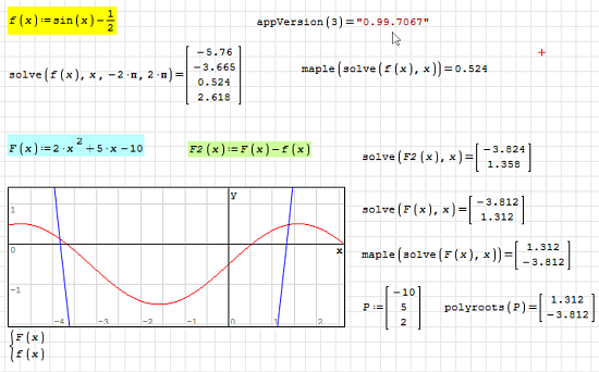

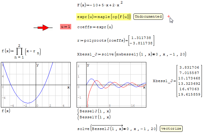

The attached sm file also crashes some times when inputs to Polyroots, solve, maple(solve)
are changed or adjusted.

#10 Опубликовано: 12.05.2019 04:44:58
Tried but it did not crash.

I had 2 or 3 crashes while testing. It was very strange.
I will try more variations and post if there is any crash.
That shouldn't happen, but maybe on latest beta.
1. Polynomials have unique Lagrange format [lot many books are wrong].
2. maple(op(F(u))) will save you manual steps and possible typo errors.
Maths eigenAll Companion.sm (62,14 КиБ) скачан 1297 раз(а).

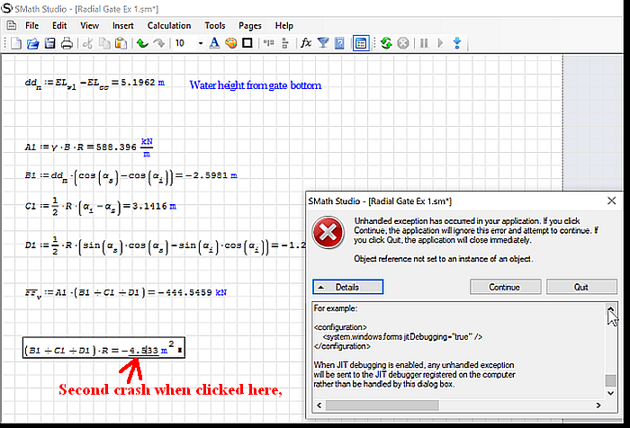

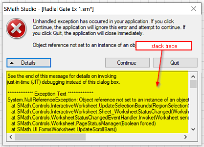

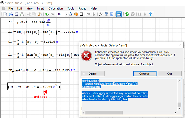

Even after a Clean Re-installation, crashes continued to occur on and off.
Attached sm file crashed when I was doing some changes to either default units,
or copying etc. (I'm not sure). Note where I clicked.
Radial Gate Ex 1.sm (194,77 КиБ) скачан 1276 раз(а).

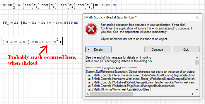

Second crash. BTW how do I create stack traces and copy?
Radial Gate Ex 1.sm (195,59 КиБ) скачан 1326 раз(а).

Still not able to reproduce but at least we have an hint.
Simply copy the text from the error window

Third crash occurred, and the stack traces (in MS Word) attached.
