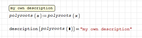

during study Smath Studio , I would like to add some my own description to functions just for better memory / understanding .
so is there anyway to do that?
i have tried for example :

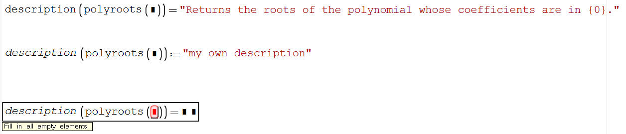

#2 Опубликовано: 22.05.2024 14:43:18
You can add your own description(s) in this way.
besides , is it possible to support orther languages?
If you mean in the description, just right click on the region that holds the definition and change the language on the context menu; you can add a description for each language.
If you want another language to be supported, you have to ask Andrey directly.

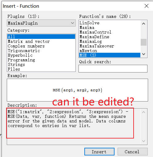

hi,Davide, thanks very much, this method works, but it didn't fully achieve my goal.
what i want is add some note about that function in Function-Description ,
Snipaste_2024-05-22_20-01-34.jpg,
and in the Example field , it didn't give a truly example but a syntax to call that function ,
so i wonder if there a way to add my own description about that function .
thanks.
#4 Опубликовано: 22.05.2024 20:57:29
AFAIK that's not possible. The dialog loads the descriptions stored in the plugins at program startup. Currently the only way would be to recompile the plugin with your own descriptions edited in the source code.
that seems hard for me..
