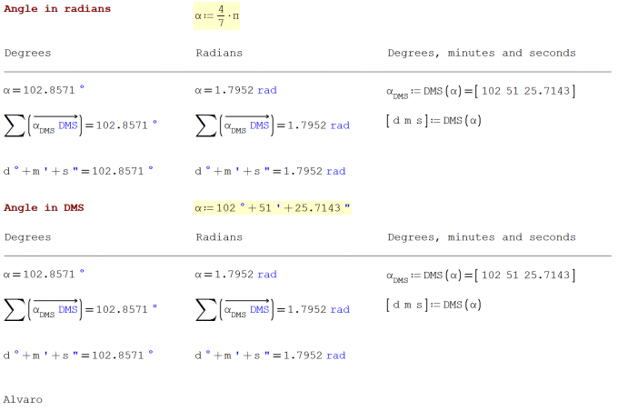

Hi. Here, my workaround.
DMS.sm (17,67 КиБ) скачан 1143 раз(а).
Hmmm... The separate units use is interesting. I am so inexperienced with SMath I can't figure out how to enter the summation portion.

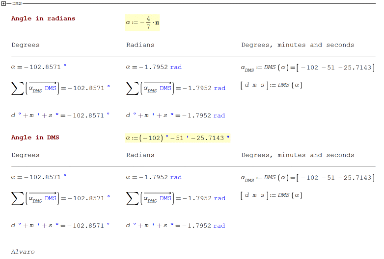

I think I will need to leave the negative angle input as [ -d -m -s ] with this approach. Would you agree?
Ah-ha! The vectorize function.
Guess yes:
