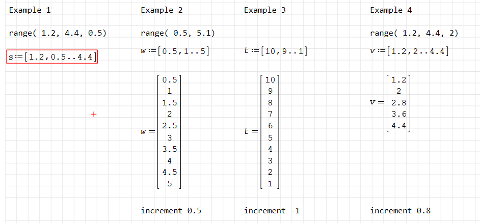

WroteI am studying with Introduction to the use of SMath Studio Prepared by Gilberto E. Urroz, May 2010.
I don't understand something in ranges and would like some explanation.

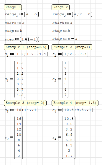

#3 Опубликовано: 03.05.2023 22:34:30
WroteExample1 is a definition error, and I'm curious how increment is defined in examples 2-4.
range() function has two sub functions.
One is with two, other with three parameters.
range() with two parameters has step 1 or -1.
It depends on whether a less or greater than b.
range() with three parameters is relation of start, stop and added.
added is equal to start+step. step can be negative or positive.
When added is greater than start, range will increase.
If added is less than start, range will decrease.
I hope picture below helps to clarify.
Regards.
