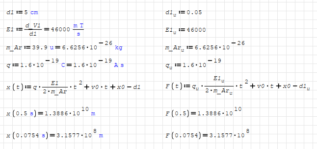

Hi I'm trying to solve an equation (see in the attached file) where the solution , the number should be small but for some reason which i can't understand , the app doesn't provide me a solution.
Why is that?

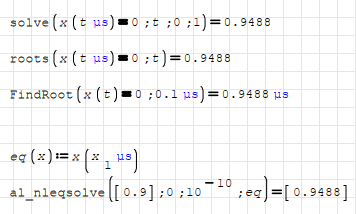

Hi Elis02,
Native solve() is nota robust solver, so it's convenient use functions as Solve() from Maxima plugin or FindRoot() from Non Linear Solvers plugin.
You need provide a value to x(t) for asking for a value of t that satisfies the equation, in the form "x(t)=k, t" where k is the value you expect obtain when replace for t:
Best,
Oscar

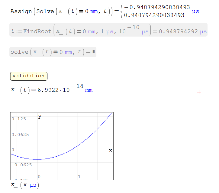

#3 Опубликовано: 02.11.2023 00:09:46
Numeric solvers don't like units.
Either don't use them or add units to solvers.
Entering a range/interval will help for solve().
Findroot() won't need unit addition btw.
test_s_math_solved.sm (12,16 КиБ) скачан 1365 раз(а).

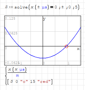

#4 Опубликовано: 03.11.2023 02:32:22
Jean has ignored units, manually input E1.
As usual, these made him totally wrong.
He doesn't have correct answer.
This is Jean's plot;
This what it should be;
If you don't know, then don't say.
Your mistakes are harming this community.
Alvaro 03.11.2023 02:50:00, Oscar Campo 03.11.2023 05:24:00, NDTM Amarasekera 03.11.2023 09:00:00

Jean, look and learn. This is how you eliminate units.
Btw, why did you delete all your meaningless replies?
Can you see the problem Jean?
You forgot your unit conversions.
m_Ar and E1 needs magick numbers in your approach.
If you would capable to work with units, no coefficients needed.
Everything is simple, clean, easier to apprehend, much easier to manipulate with units.
