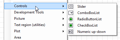

[SS-69]: Enabled MenuButton grouping in MainMenu;
And here it is the first application of this feature: I've updated some of the plug-ins in the Extension Manger. Once downloaded you will find ComboBoxList, NumericUpDown etc... grouped in the "Controls" folder; PieChartRegion now is under the "Plot" folder (same can be done for other plugins by each developer)

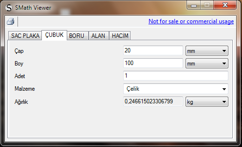

Is it me or SMath Viewer evaluates results with Decimal Place setting not considered?
Smath Studio is fine with it, but Viewer show results which has maximum possible decimal places.
