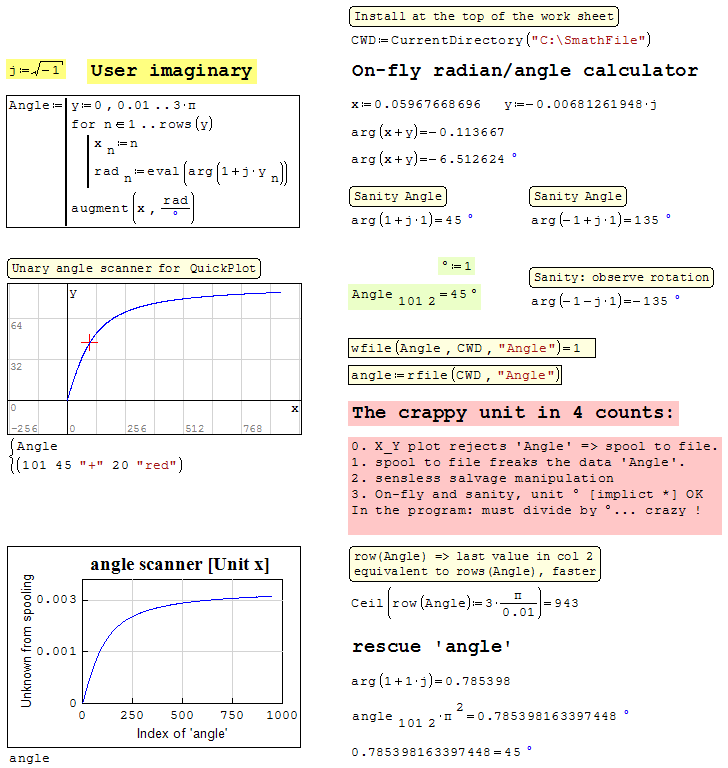

This the 'PJ" version [PJ = Pyjama]
1. Define imaginary user style 'j'
2. Don't re-use 'j' as index.
3. No need to spool to file, but X_Y plot
does not take unit ° in "Angle" [Not defined].
I have removed previous posting and work sheets.
Cheers, Jean
Angle Data 'j'.sm (9,59 КиБ) скачан 1221 раз(а).

#5 Опубликовано: 25.04.2016 00:31:18
... just watch the unit system in your Engineering projects.
Angle Data 'j'.sm (16,53 КиБ) скачан 1190 раз(а).
