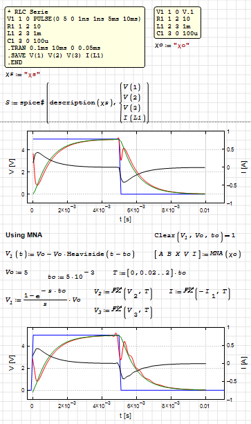

New version, more compatible with spice# sintaxis.
spice# and MNA v2.sm (636,64 КиБ) скачан 1245 раз(а).
spice# and MNA v2.pdf (1,63 МиБ) скачан 905 раз(а).

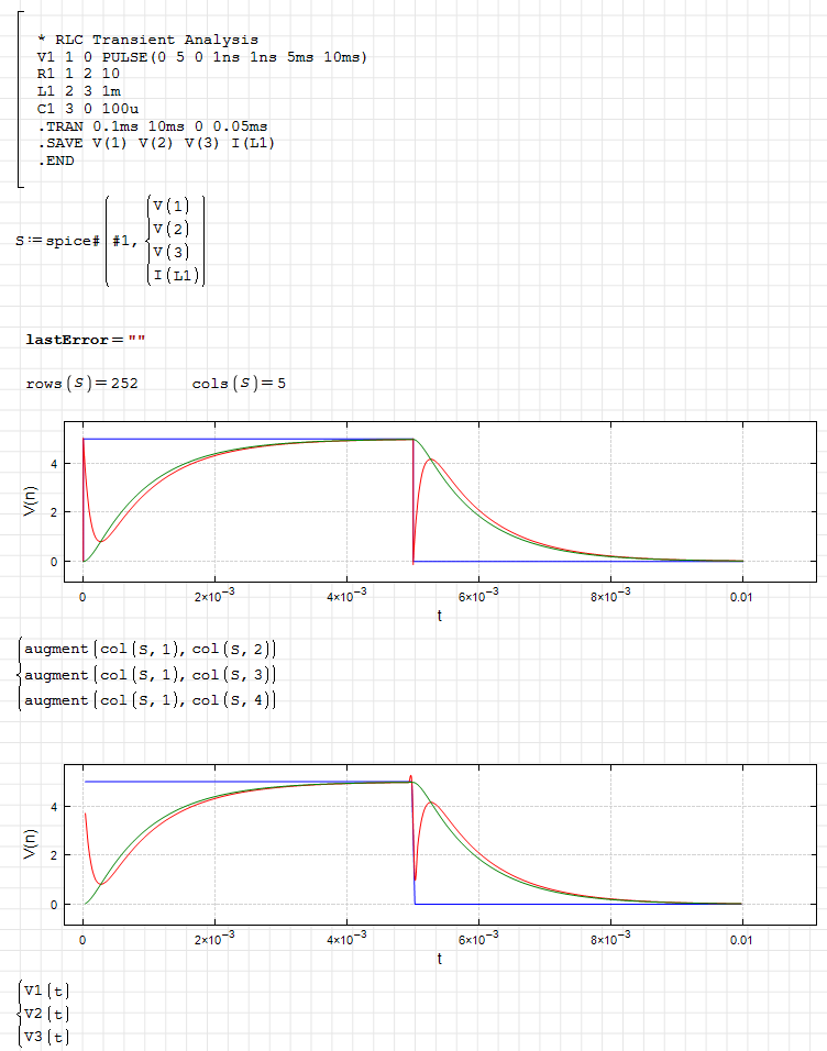

Plugin updated. [BETA]
Changes:
- expanded capabilities of spice#() function.
spice#-tran-example01.sm (10,7 КиБ) скачан 623 раз(а).
Отредактировано 12.09.2025 17:03:55

#11 Опубликовано: 11.09.2025 04:06:20
1 081 сообщений из 1 754 понравились пользователям.
Hi. Using MNA method
spice# and MNA v2.sm (653,28 КиБ) скачан 610 раз(а).

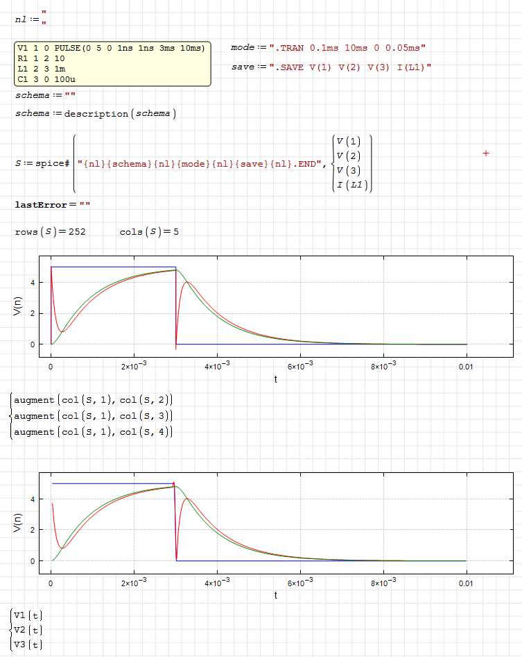

#12 Опубликовано: 11.09.2025 15:34:13
1 533 сообщений из 1 850 понравились пользователям.
spice#-tran-example02.sm (11,84 КиБ) скачан 624 раз(а).

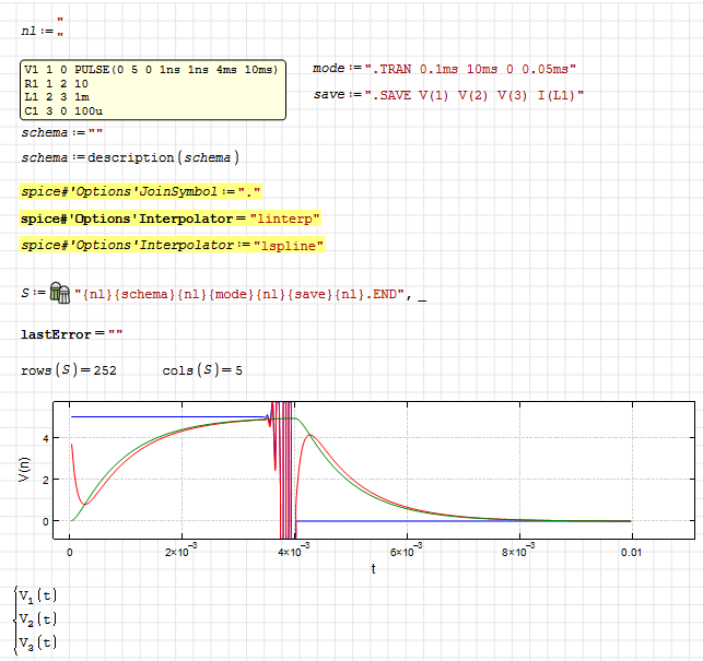

SMath Studio compatibility History page Changes AI Assistant

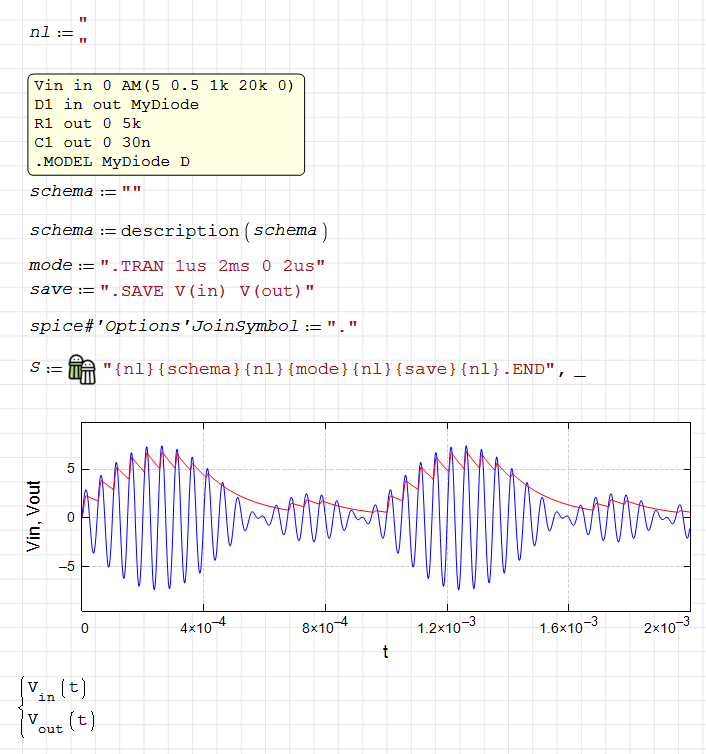

Plugin updated. [BETA] 🤪
Changes:
- Custom Icon/Glyph Rendering
- Automatic Export from .SAVE Statement.
- Automatic Interpolation Function Generation.
spice#-tran-example03.sm (11,78 КиБ) скачан 623 раз(а).
Отредактировано 12.09.2025 17:05:04
Oscar Campo 12.09.2025 10:04:14

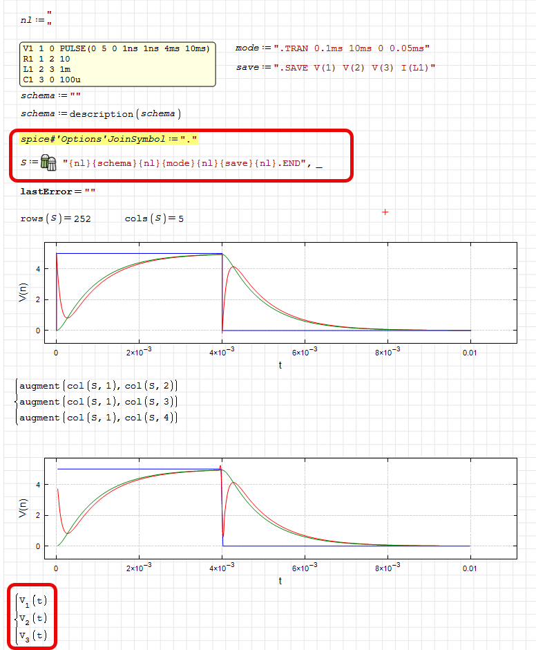

#14 Опубликовано: 12.09.2025 10:09:29
Changes:
- Refined Glyph Rendering;
- Added "spice#'Options'Interpolator" Operand.
Отредактировано 12.09.2025 17:05:27

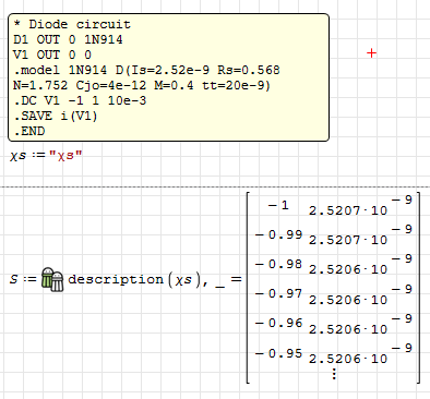

Hi Viacheslav. Great work, congratulations. Some questions:
I was able to introduce an ampop, which is a fairly theoretical model without many physical parameters. How did you introduce the diode model?
Is it possible to import ltspice models more or less automatically?
Another question: how could V1, V2, and V3 be graphed in your 3DPlot plugin? The CreateSpace function is new, isn't it? Do you have examples of how to use it? Generally, these graphs can't be created in simulators, and the data must be exported to MATLAB or other similar software.
I can tell you how to proceed, i.e. the algorithm for setting the problem.
If you want to simulate the scheme, then you need an example. Nowadays, in the programming world, it is common to accompany source texts with tests. These tests, as a rule, cover many typical tasks.
You need to find these texts, see the link below. Then introduce Gemini to the matter so that he can help create an adequate syntax. I simply throw the test sources into the chat as an example and say what I need.
Not at the moment, but I can make it so that it will be possible. I don't have enough time to finish this plugin, as it is a bit more complicated than X-Y Plot.
Yes, CreateSpace() is a new function, I asked Gemini to make it, but I haven't used it yet. The plugin does not support the data format returned by this function.

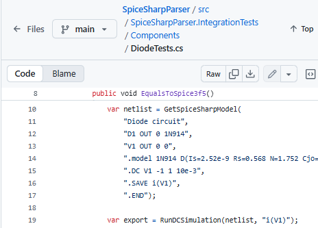

Links:
1. SpiceSharpParser.IntegrationTests

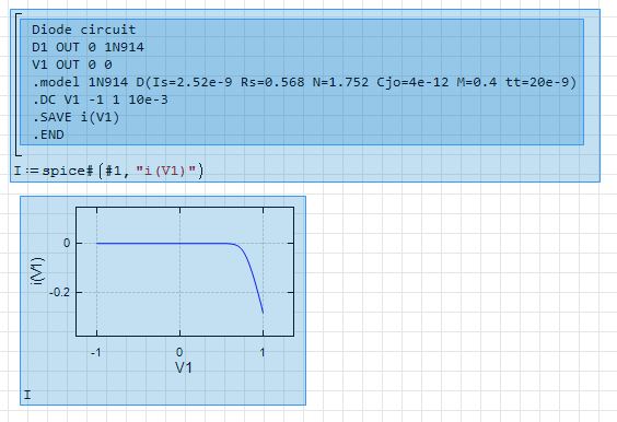

Hi Viacheslav. Thanks, the link you provide shows how to simulate components, for example, a diode:
One more question: An option to have outputs with units? I think it would just be a matter of identifying time, volts, and amperes. It would be very practical to be able to use milli, micro, and nano prefixes.
