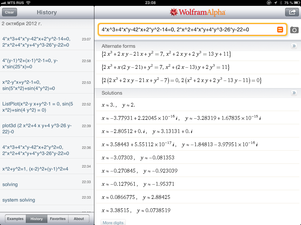

Example 1. Finding extremes: Himmelblau's function:
[MATH]f(x;y) : (x^2+y-11)^2+(x+y^2-7)^2[/MATH]
[MATH]sys(4*x^3+4*x*y-42*x+2*y^2-14=0;2*x^2+4*x*y+4*y^3-26*y-22=0;2;1)[/MATH]
P. S. Buchberger's algorithm can solve systems like that much easer.

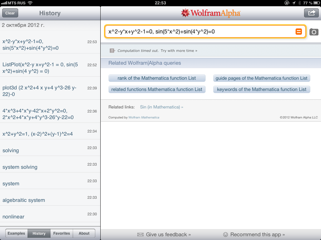

Example 2. Finding roots: System 1.
[MATH]sys(x^2-y*x+y^2-1=0;sin(5*x^2)+sin(4*y^2)=0;2;1)[/MATH]

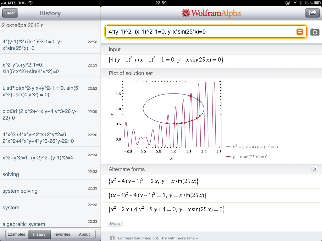

#3 Опубликовано: 02.10.2012 10:43:03
Example 3. Finding roots: System 2.
[MATH]sys(4*(y-1)^2+(x-1)^2-1=0;y-x*sin(25*x)=0;2;1)[/MATH]

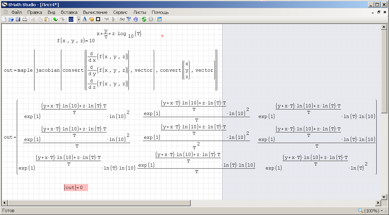

I tried to use your files explaining how to find extremes of the Himmelblau's function and to apply this to NLS (nonlinear least squares) problem to my example file NLminimization, but without success. As I expected, The Jacobian was the first problem. I struggled many times with obtaining Jacobian of the object function S( b ) , or f( x,y,z ) in this and similar examples, and SMath could not find the derivatives most of the time. For some other cases it was sometimes rather time consuming. It seems to be complex for the SMath engine to apply any Jacobian based minimization to this kind of problem. You could see in the attached file where I stopped.
I do not know if there is any sense to use Jacobian based minimization procedure to these kind of problems in SMath. I would appreciate any comment from you regarding this.

Radovan, I think this is not a good idea. This function will have zero determinant in the method.

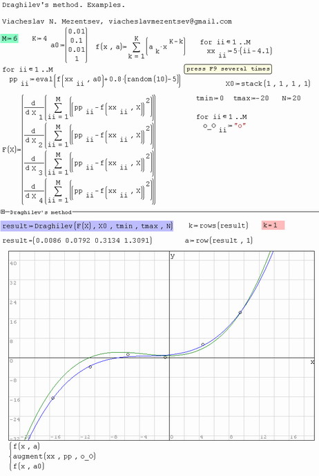

#12 Опубликовано: 04.10.2012 21:54:18
Radovan, I can't say something in your case. Yes, there is a problem with the Jacobian. I can't understand what exactly is the problem, so we turn to a simple example for now.
Draghilev's method. Finding roots. System 2 version 0.2.smz (7,06 КиБ) скачан 1318 раз(а).
Radovan Omorjan 05.10.2012 02:28:00
#13 Опубликовано: 05.10.2012 00:51:53

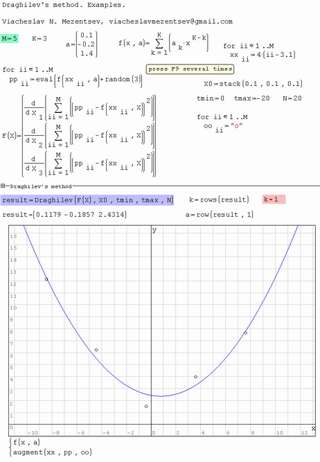

I have something fixed in the plugin. Download the new version and try to calculate this example. Everything is the same, but now it sometimes works even with five points. Then the problems begin with the maple().

#15 Опубликовано: 05.10.2012 08:10:05
Unfortunately, the plugin can't correctly translate all that much data with which it communicates with the Maple. Do not forget to delete the file mvr5.txt. Here you can see the language in which the plugin communicates with the Maple. And one more example. I increased the dimension of the problem and the number of points.

#17 Опубликовано: 05.10.2012 09:09:37
Press F9 need to generate random numbers. I think that this should be on the expression where it is described (inside it). I get the result after every of 5-7 pushing. You can also increase the spread of the points (instead of a factor of 0.8 to take a little more).
Hmm. As I see it, in SMath used arc*() style, isn't it? (Russian interface) If Europe is different, I need to give a complete list of mathematical functions, where you need to make corrections, and three letters of the interface language (or just language name).

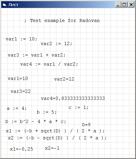

Radovan, if you want to understand it better, then you need to try to write the interpreter symbolic computation by yourself. It's not that hard. There is even an introductory book - Computer Algebra with SymbolicC++.
P.S. On the picture is a simple example of the SMath-style calculator, which is written in VB6: sources (draft, russian).
