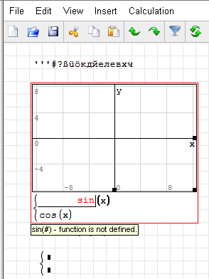

Great work!
I experience input problems with german keyboard:
- cannot input units (' character does not work)
- I have to input a right (closing) paren in order to get a pair of them.
These problems also appear in smath live and in Knovel interactive equations.
Edit: Rainbow game: Modeler region does not accept input (no mouse response). Moving the modeler region makes it jump to top of the sheet, there seems to be an issue with area regions, if I open the first one, the modeler region jumps inside it and cannot be moved any more.
Edit: F5 just inserts the letter t, the other function buttons are mapped to other regions, F12 creates an empty placeholder.

Looks promising!
That now allows to add units (' character still not working).
How are we supposed to scale 2d plots? Mouse wheel just scales the whole GUI.
Any plans to support operation of the site via touchscreen/tablet? If the cloud version could run locally, this would be a generic Android/iOS version...

Can't create text regions. Neither can I input the double quote sign nor has the menu entry any effect.
Currently, if you reload the page, the sheet is cleared without warning. How about a confirmation dialog?
Thank you. Will fix this. For now you can just write the text, so the region will automatically switch to Text on the first spacebar press.
I'm working to have direct links to the current worksheet, so refreshing will not clear the document anymore. This feature will be available soon.
Thanks, I forgot about this way to create text regions.
Entering TAB now stops any region from accepting any further input until it looses focus.
BTW, on my tablet (android) the page scrolls unintendedly when the keyboard opens. This sometimes makes the region disappear behind the virtual keyboard.
