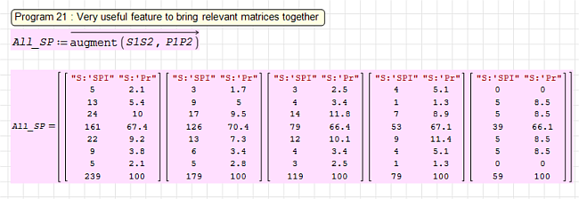

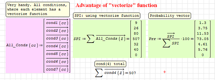

On the request of a fellow Engineer, the attached SM program was developed
to find the Standardized Precipitation Index (SPI).
58 years of daily precipitation data was available.
The SPI is widely used to analyze meteorological drought on a range of
time scales. There are proprietary software packages for this purpose.
The “vectorize” function was pretty handy and fast in analyzing various conditions.

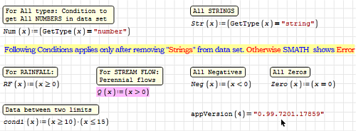

Attached file may be useful in handling data, where it may be
necessary to extract numerical values removing any strings, or
negative values, zeros etc.
Data Analysis Using Truth Table.sm (78,91 КиБ) скачан 1370 раз(а).

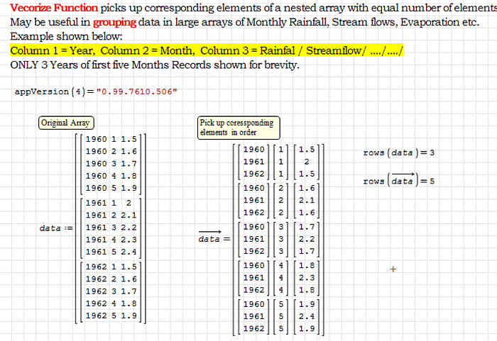

Advantage of vectorize function revisited.
Another practical example attached, with extensive use of the vectorize function. No loops used.
Comments by Martin, Jean, Razonar and others on this subject much appreciated.
Hope this may be useful for beginners.

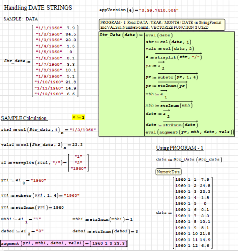

#9 Опубликовано: 16.11.2020 14:13:48
NDTM Amarasekera
NDTM Amarasekera

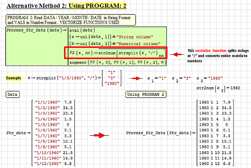

Attached is a simplified version of a project work for demonstration only.
The data file consists of date strings, and hence, had to be transformed into numeric.
Hope this may be useful for beginners. Vectorize function very useful in this exercise.
Handling DATE STRINGS.sm (16,17 КиБ) скачан 1346 раз(а).

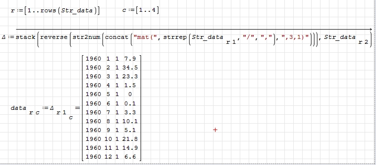

#10 Опубликовано: 16.11.2020 20:48:19
The secret is inside your nice piece of work ... superb, thanks.
Take care my Friend ... Jean
#11 Опубликовано: 16.11.2020 23:58:06
Hi. Handling data strings you have also this cheat for convert dates to numeric matrices.
Handling DATE STRINGS.sm (20,56 КиБ) скачан 1292 раз(а).
sergio 17.11.2020 14:39:00, NDTM Amarasekera 17.11.2020 22:29:00
#12 Опубликовано: 17.11.2020 01:41:25
NDTM Amarasekera
NDTM Amarasekera
Thank you Jean for your kind words and encouragements. Take care.
Thank you Razonar for the superb alternative. Take care.

#14 Опубликовано: 02.02.2021 04:35:43
NDTM Amarasekera
NDTM Amarasekera
Revised program to handle date strings.
Handling DATE STRINGS+Alvaro.sm (43,62 КиБ) скачан 1343 раз(а).
Alvaro 02.02.2021 15:35:00
#15 Опубликовано: 02.02.2021 11:27:50
Thanks Collab for that most useful work.
Saved ... for future use.

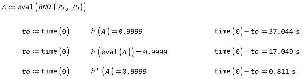

#16 Опубликовано: 02.02.2021 15:44:06

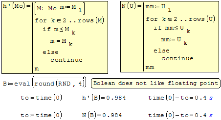

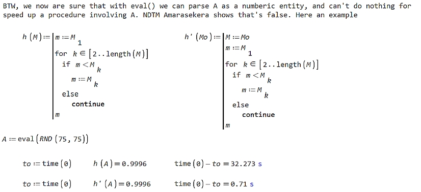

Hi Amarasekera. Yes, that one, thanks. The fact you're showing despite to me about the speed in procedures with arrays. In the attached some comments about the need to redefining M:=M where M is a matrix argument in a procedure.
EvalTest.sm (17,47 КиБ) скачан 1323 раз(а).
EvalTest.pdf (73,82 КиБ) скачан 700 раз(а).

#17 Опубликовано: 02.02.2021 18:53:27
Your last Speedy Gonzalez is the Smath Numerical Fairy.
As it looks, pure numerical code coincidence as a fact.
Slightly adapted for convenience SS 6179
Thanks, cheers ... Jean
Maths eval(,) TEST.sm (16,84 КиБ) скачан 1321 раз(а).
#18 Опубликовано: 02.02.2021 19:26:52
Ruben Sidranski
Ruben Sidranski
Alvaro,
Are you showing that by redefining Mo variable, within the program, it speeds it up 30 fold? That makes no sense
The only thing that remotely comes to mind is that M, being defined within the program structure as M:=Mo, is not having to read for the variable from the outside.
Have you, or anyone else, tried this on other programs?
#19 Опубликовано: 02.02.2021 19:54:30

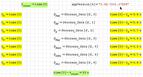

Alvaro,
Yes. Please, try to check in your environment if this is true also. (Notice that my laptop is very slow, because always is running something else or overloaded by some other procedures)
Yes. For this was the issue in the original Amarasekera work, and why I say that he was the first showing this behavior. But I have other codes where using M:=M speed up slow procedures. Actually anything with a loop over a matrix.
Here intermediate timing result, which I can't explain
