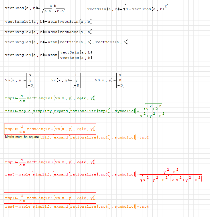

Seems, like I faced 2 bugs simultaneously... From four (almost) equivalent expressions only one is calculated correctly.
1. Wrong derivative atan() with 2 arguments, shown in red.
2. Two expressions are shown in yellow, where error is reported, although the same term with dot products is successfully calculated in another expression (shown in green).
testderv.sm (14 КиБ) скачан 69 раз(а).

I use Maple for the first time. I found in SMath no possibility to simplify expressions (and also wrote a corresponding Feature Request). Maple plugin was the first possibility, which I found, to get readable expressions.
Both bugs here have nothing to do with Maple. To ensure that differentiation is performed by SMath, I have used Martins implementation of "symbeval()" function. Maple is used only to show differentiataion results in readable form.
testderv-sm.sm (15 КиБ) скачан 64 раз(а).

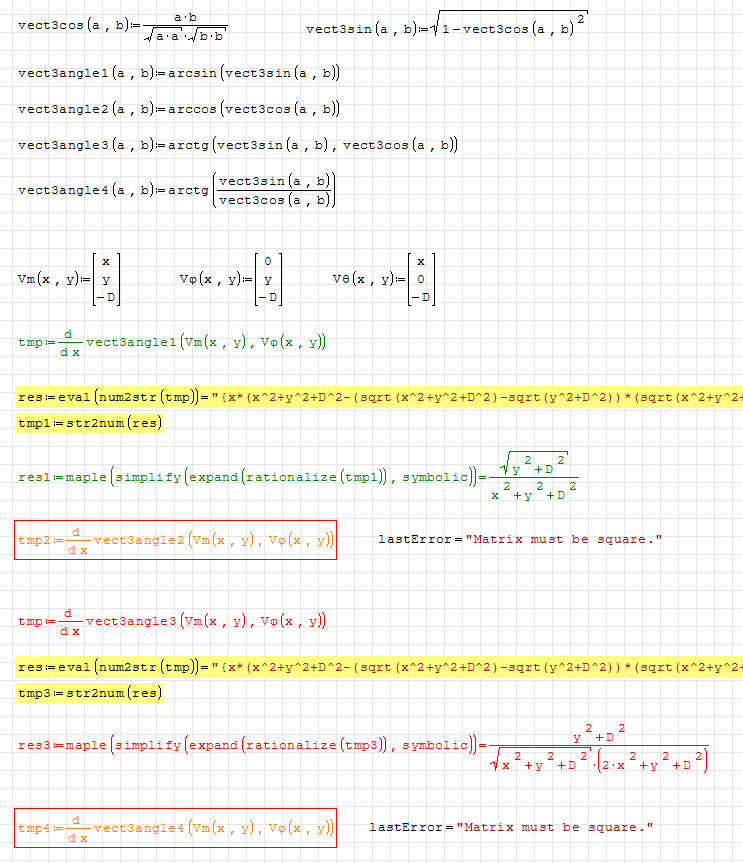

The script is correct as sanity check below
but result is NOT ! as proved ... Ah !
As it looks Maple is the guilty companion.
Hello Martin, Adventurist,
Martin, one day you gave me a trick "to be more divine".
Here is one to make Maple expansion "more divine".
There is a missing link somewhere.
testderv-sm (2).sm (71 КиБ) скачан 74 раз(а).
