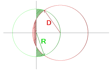

Is it possible to make a type of shading like the one shown in the figure?
Circle_Hatch.sm (27 КиБ) скачан 67 раз(а).

It is possible to make a type of shading like the one shown in the figure
Thanks Carlos, superb.
You can have it shaded in all web colors as well.
I didn't add the arrows ... The two circles could
be done unicolor via rkfixed.
Maths Goat Radius.sm (132 КиБ) скачан 68 раз(а).

CBG, your algorithm for drawing a circle can be simplified.
Circle_HatchM.sm (30 КиБ) скачан 58 раз(а).

Beside Jean's random hatch, you can also fill a region with brute force algorithms, or using CreateMesh, with some restrictions (Origin must to be inside the region).
Circle_Hatch.sm (42 КиБ) скачан 79 раз(а).
