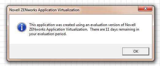

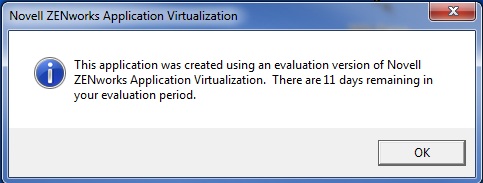

Hi Andrey,
I am getting a Novell ZENworks Application Virtualization Popup when running Smath
version 0.96 (build 4868). It is informing me that there are only 11 days left before the trial expires.
Louis

#2 Опубликовано: 19.06.2013 09:34:35
Confirmed (SMath Studio 0.96.4868 portable)
regards,
Davide

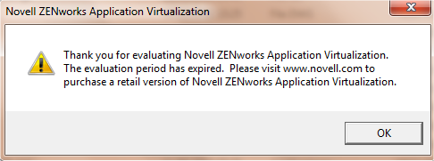

#8 Опубликовано: 01.07.2013 08:20:59
Expired
Only to mention it, the same problem appears in the 0.96.4883 portable.
regards
Davide
