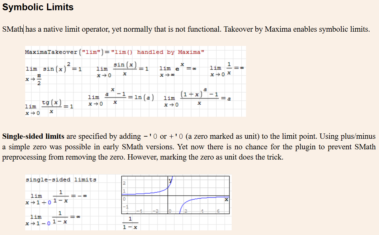

The Maxima plugin can handle limits symbolically. Below you find a preview of the SMath with Maxima handbook, it is to appear with the next release of the Maxima plugin. Ordinary limits work in the current version. Single sided limits will be part of the next release.

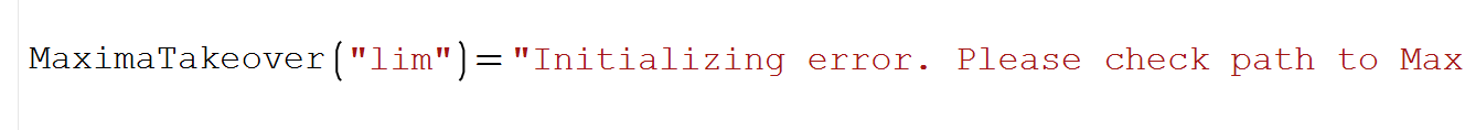

But I have
Send please the SMath-file

Do you have maxima installed?

Instructions for installation
Install.pdf (155 КиБ) скачан 105 раз(а).
