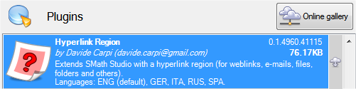

First Beta available through plugin's Gallery.
Documentation and translation sheet in the first post.
Best regards,
Davide

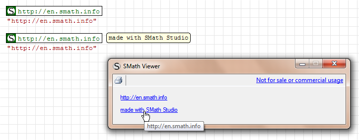

- Support for SMath Viewer
best regards,
Davide

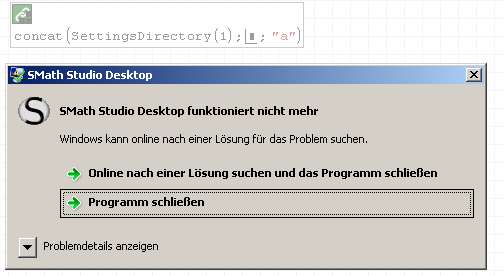

SMath crashes when I try to edit the input expression of a hyperlink.
I write concat with three arguments, fill in the first and the last. As soon as I want to type to the second placeholder, the crash occures.
#16 Опубликовано: 09.08.2013 19:07:15
1 436 сообщений из 2 918 понравились пользователям.
Fixed, please test the update
