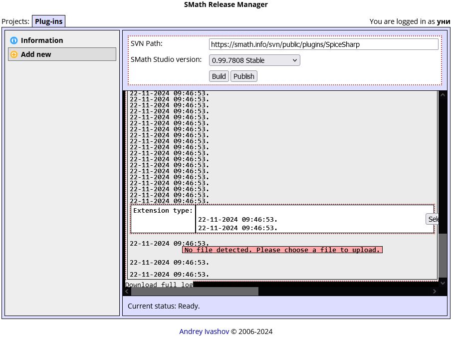

I can't publish the plugin
#2 Опубликовано: 22.11.2024 16:11:36
Thank you for the report.
Checking...
#3 Опубликовано: 22.11.2024 16:33:13
Reproduced. Working to fix it.
#4 Опубликовано: 22.11.2024 22:15:16
Issue is troubleshot.
The reason is that the file of the plug-in is 35.5 MB which is the largest plugin right now. Server does not accept such amount of bytes because of security reasons.
Current maximum request limit is 30,000,000 bytes, which is approximately 28.6 MB.
I'm checking what can be done here...

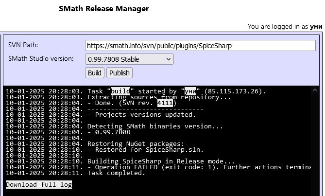

#9 Опубликовано: 11.01.2025 00:29:51
There is no log, the reason is unknown.
Andrey Ivashov 11.01.2025 00:43:00
#10 Опубликовано: 11.01.2025 00:50:50
Thank you!
If you click on the Download full log link at the bottom you'll see the following error:
"error NETSDK1050: The version of Microsoft.NET.Sdk used by this project is insufficient to support references to libraries targeting .NET Standard 1.5 or higher. Please install version 2.0 or higher of the .NET Core SDK."
Will try to install latest .Net SDK.
#11 Опубликовано: 11.01.2025 01:12:39
As I wrote earlier, this log has not been displayed for me for many years. When I try to download it, I get an error: File not found.
#12 Опубликовано: 11.01.2025 01:20:11
Sorry, forgot about it.
Building a plugin fixed, but as I see an output package contains folders like cs, de, es, fr, it etc... - this will break plugin installation. This is known issue but requires new SMath Studio build.
The best solution for now is to exclude these folders from output (they must be a part of third-party Nuget I think).
