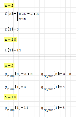

"The variables should be assigned to their desired values only after the function is defined." sic!
That's true only if you don't use line() to define your function; in this case to avoid the behavior you must set the optimization of the function definition to "numeric".
