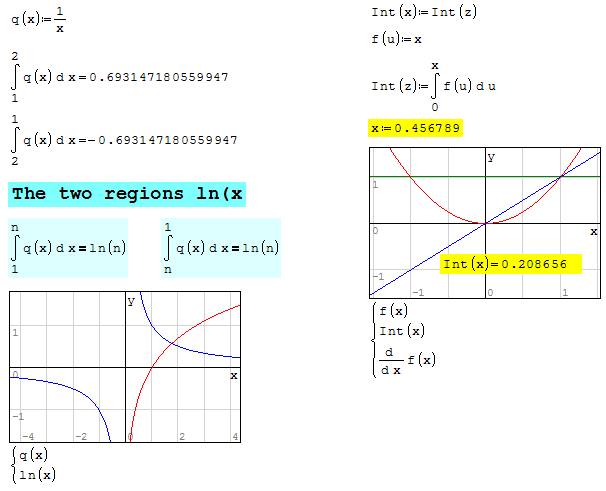

#3 Опубликовано: 21.05.2016 08:47:42
Try the formal procedure before uninstaling Maxima.
The remaining of the work sheet may not work at all.

#4 Опубликовано: 21.05.2016 09:13:23
read more

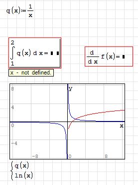

#5 Опубликовано: 21.05.2016 13:46:20
Basile
Basile
I am using latest build of SMath and Windows 10.
Basile
#6 Опубликовано: 21.05.2016 16:22:47
You have to use maxima takeover as explained here, otherwise disable or uninstall the plugin.
#7 Опубликовано: 21.05.2016 21:45:44
If version(s) past 5346 disable the integration operator,
to me : it is a bug by definition as exemplified earlier.
#8 Опубликовано: 22.05.2016 14:54:27
Found the issues, I'll commit the fix ASAP
