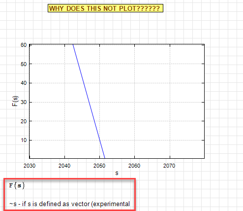

My Mathcad brain causes me to misunderstand some SMATH syntax. The is especially true in XY-Plots. I have created two function: F(s) and F1(s), which is discontinuous. If I redefine the functions as vectors and use augment to define the x-axis, the plots look okay. However, when I try to plot just the function, it does not work. These plots do not create a trace list as with the vector versions. F(s) just doesn’t plot. F1(s) also doesn’t plot, plus it gives an error.
In short, how do I plot simple functions?
Any help is appreciate, as always.

Hi JReg. If I'm not wrong, just try to plot both with an undefined variable like F(so) and F1(so). The problem is that 's' is a vector.

Thanks much. That works.

Due to the implementation features, you can't use the function argument the same way you do it in Mathcad. The component allows you to use a vector variable if you add a tilde before the name.
