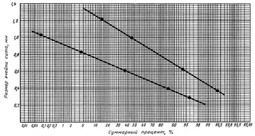

How can I get a function from this plot?

How can I get a function from this plot ?
1. Probably from the expensive digitizer suggested by Richard [Mathsoft Collaboratory]
2. Piecewise from Tracer.
3. Try Mathsoft digitizer.
4. Smath difficult
At this point from the collected data set, fit a model function.
Cheers ... Jean.

How can I get a function from this plot? 🖼
That is a straight line on a semi-log graph; you can reference this handout: https://inside.mines.edu/~epoeter/_GW/LAB/EquationsOfStraightLinesOnDifferentTypesGraphPaper.pdf
Per this handout, your equation should be
y = b + m*log(x)
where:
  • m = difference in y over one log cycle of x
  • b = y value corresponding to x=1
Hi. You can try this post Approximation of a functional curve in a digital image or this other one: Embedding images into a plot

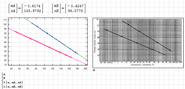

Hello Valery,
some Smath digitizing utilities
Cheers, Jean.
Digitize Tracer 15.sm (28,83 КиБ) скачан 1287 раз(а).
Digitize OVNI Copy.sm (69,15 КиБ) скачан 1291 раз(а).
Digitize Contour Isocurve Himmelblau Copy.sm (106,67 КиБ) скачан 1355 раз(а).
Digitize Curve.sm (295,86 КиБ) скачан 1275 раз(а).
Digitize Contour.sm (829,05 КиБ) скачан 1352 раз(а).
Digitize Clean_Strip_Smooth.sm (1,76 МиБ) скачан 1379 раз(а).

#8 Опубликовано: 06.06.2023 17:11:16
Hi. Hope this helps.
Modeling a functional curve in a digital image.pdf (860,39 КиБ) скачан 833 раз(а).
Modeling a functional curve in a digital image.sm (1 МиБ) скачан 1405 раз(а).
