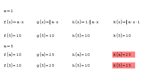

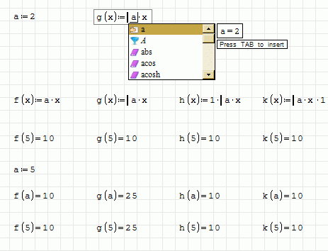

    I'm not comftable with this. As shown in the picture, when write 'g', 'a' appears as 'a = 2'. Others programs have a warning message for the use of global variables locally. I think that you must to introduce a global command to catch the value of a in g(x).
    Regards.

    #14 Опубликовано: 01.10.2012 09:44:55
    adiaz
    adiaz
    5 сообщений из 25 понравились пользователям.
    Hi. In my example it is (|a*x)*1, but yours is (|a*x*1)
    Regards.
    #15 Опубликовано: 01.10.2012 10:03:28
    Hello Alvaro,
    You are right. This might be sometimes quite frustrating. Everything looks the same but the result is different. SMath can not deal with braces correctly and satisfactory quite often
    This one is one of the examples of that problem I mentioned few times here on the Forum.

    Well, as I see, this the price for obtain clarity in others expression. Mathematica have a lot of this problems with TraditionalNotation, Maple too. But at the end, this give less mistakes that working with parenthesis and text notations.
    Defining a function as f(x) := 1*(| ... ) make all variables in line(...) as globals.
    Regards.
