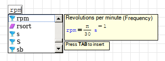

The built in revolutions-per-minute unit is unclear to me.
The description of the "rpm" unit is "Revolutions per minute", but the definition is in "Radians per minute".
As a result, when converting an operating frequency from "rpm" to "Hz', the calculated result is "radians per second" instead of "revolutions/cycles per second".
For example, if I have a component that operates at 900 rpm, it completes 900 cycles per minute, or 15 cycles per second = 15 Hz. That is the result I expect.
Instead, I get 94.248 Hz. The value of 94.248 is Radians per second, not cycles per second.
On the other hand, the description of the "radpm" unit is "Radians per minute", but the definition is in "per second". So my 900 revolutions-per-minute component is completing 900 x 2 x pi = 5655 Radians per minute. I expect 5655 radpm to equal 15 Hz, but instead I get 900 radpm = 15 Hz.
Is this a bug in SMath or in my understanding of units?
