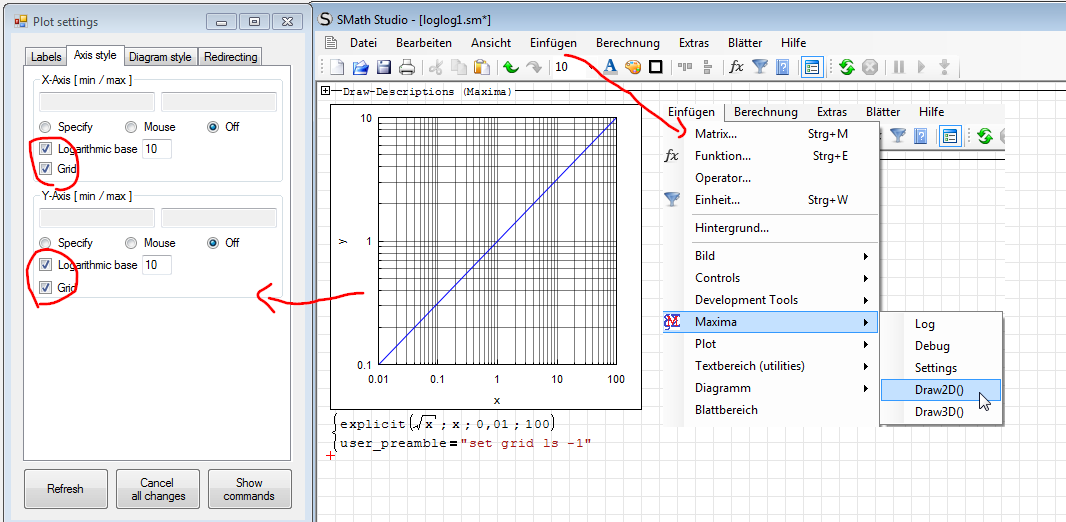

Actually, the Maxima plugin should work for the current stable SMath release. If there are any error messages, please let me know. The easiest way to get the plugin to work is to use the portable distribution (link in my signature). Then please follow the instructions in https://en.smath.info/forum/yaf_postst2078_Maxima-Plugin.aspx
There is a snippet "Draw Descriptions" to support the use of Maxima graphics commands (provides help texts in the dynamic assistant)

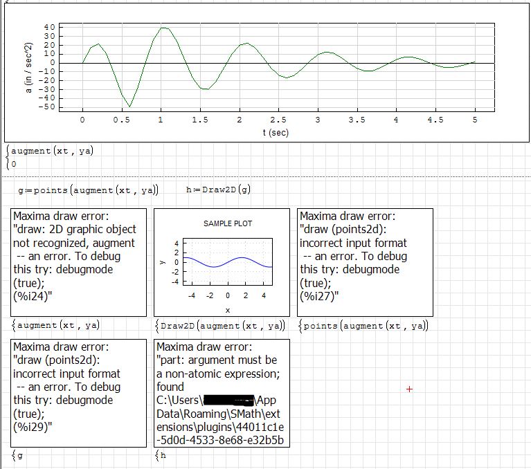

In response to mkraka, I received the attached error (error.jpg) after downloading the Maxima plugin and restarting Smath. I did however manage to get the plugin to work by selecting it from the error window followed by update.
The problem I have now is getting the plot function to work (error2.jpeg). You mentioned "There is a snippet "Draw Descriptions" to support the use of Maxima graphics commands (provides help texts in the dynamic assistant)", could you provide a link to this as your previous link gave an error.
Thanks
I don't see any images (attachments). Use the paper clip symbol in the post editor to upload and attach images.

Reply to mkraska.
Firstly, thanks for your detailed responses. The information provided in your handbook, the Maxima snippet, and your sample file, is simply outstanding. The handbook is a comprehensive and well laid out. It appears comparable with, if not better than, that produced by many high budget commercial software providers. As a support document for open source software it is truthfully impressive. Despite being non-literate in German, I found it surprising easy to follow.
Here is the error message that I am having trouble with, hopefully attached this time. I now realise that adding an attachment is a two step process (upload AND attach) opposed to a one step upload!
With regard to the Maxima installation on my laptop, it is located in the C:\ directory, SMath is in C:\Programs (x86)\, and the Maxima path has been added to the Maxima settings in SMath. The version of Smath I have is 0.98 (build 6484).

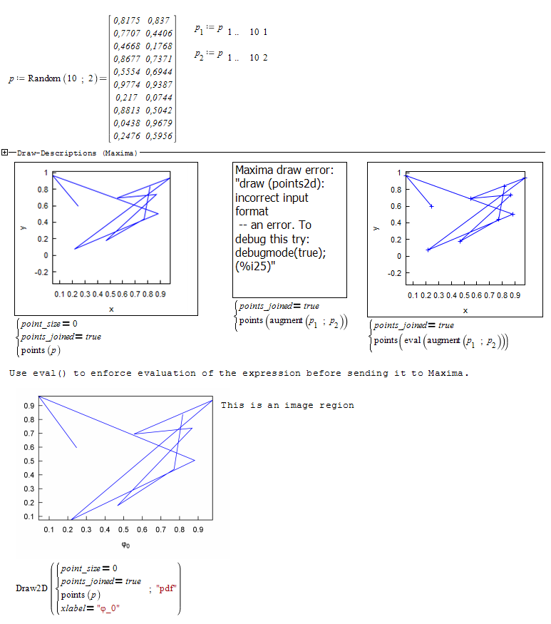

I am an SMath novice and not at all familiar with using Maxima, but I recently loaded the Maxima plugin to test out some of the graphing features.
I am trying to plot XY-scatter points that are saved in matrix-form. I can do this in the native SMath plot feature and the XY-Plot plugin, but can't seem to recreate this in the Maxima plugin...I get drawing errors.
I tried dowloading an running the "Plugin%20Maxima%20Test.sm", but it was calculating for over 10 minutes and seemed to have some calculation failures in it. I am using SMath version 0.98 (build: 6484).
Can anyone see something that I am doing wrong? (PDF and JPG attached)

The maxima test has indeed some failures in it. If run the first time, compilation of Maxima packages can take a while, in particular for lapack, which usually fails due to insufficient memory allocation in Steel Bank Common Lisp. However, CLISP is slower and can't handle unicode.
points.sm (175,46 КиБ) скачан 1201 раз(а).
points.pdf (204,64 КиБ) скачан 724 раз(а).

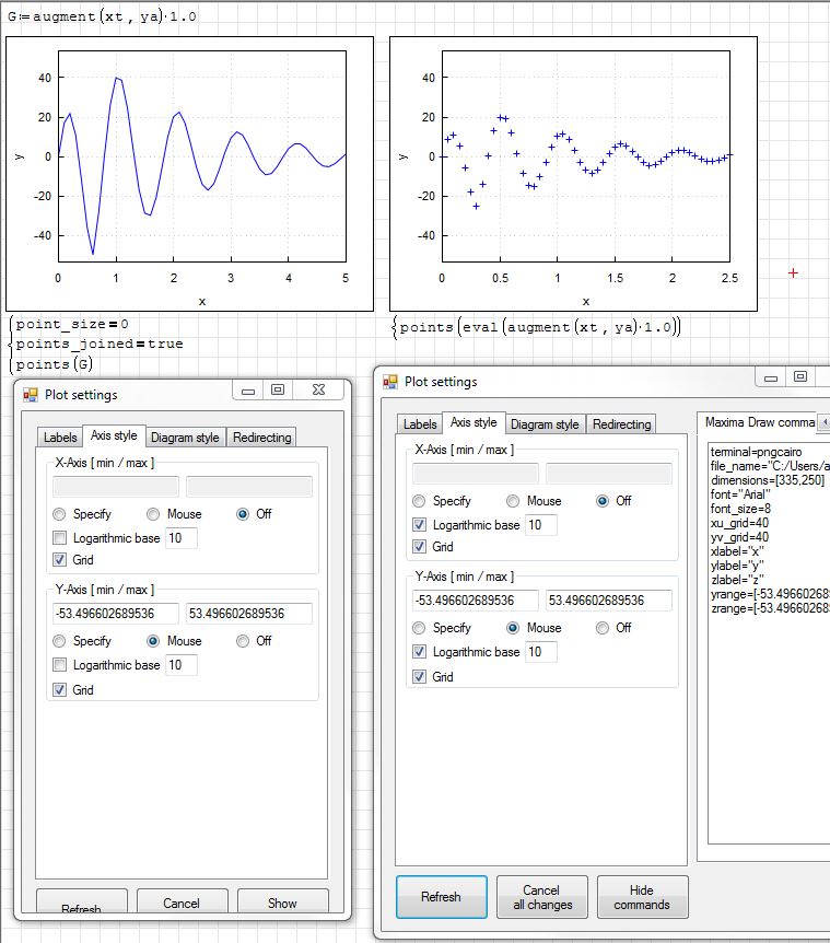

However, the "Logarithmic" scale feature doesn't seem to be working.
With the "Logarithmic" box checked off, any changes made to the points equation (applying a 0.5 factor, for example) won't even be shown on the graph.

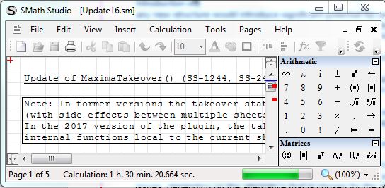

And I'm not sure if the logarithmic issue that I am having is related, but when I opened the "Update16.sm" file, it was still calculating after 90 minutes (stuck in a loop somewhere). This was the same sort of behavior that I was seeing with the previously noted test file.

SM attached (Maxima graphs are at the bottom)

The plotting function is not robust enough to silently suppress undefined values. In log-plots make sure that your points are strictly positive.
