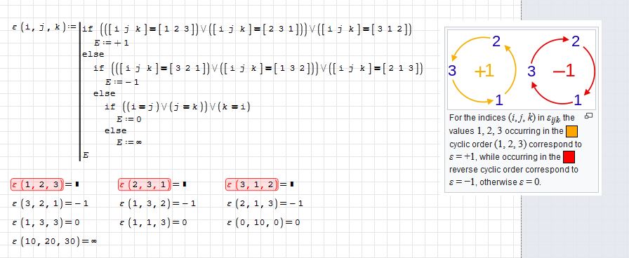

I have a symbol that nearly works for all cases. At the moment I am not sure how to get the first IF statement to work.

#2 Опубликовано: 28.11.2021 20:16:51

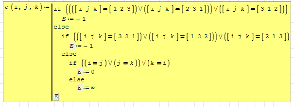

Hi. The "E" in the first if isn't the same "E" than the others. You can see that looking that the bakground isn't gray, like in all others.

#3 Опубликовано: 29.11.2021 00:04:25
John Heidenreich
John Heidenreich
5 сообщений из 67 понравились пользователям.
That fixed it Alvaro! ...
