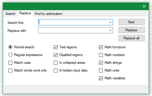

Hello friends. Is there a search/replace function in sMath Studio? Sometimes you decide to change a variable name from x to x1, for example. If there is a “search, replace all”, then you don’t have to do it one by one and it will save a lot of time.
#2 Опубликовано: 20.01.2018 04:37:36
In a region, you can use the F8 key an you'll be able to rename all local variables/functions at once.
Globally, you can do it with the Text Region Utilities plugin.

In your Smath Studio, go to: Tools > Plugins... > [switch the top-right button: Local Storage > Online Gallery] and search the plugin, then double click it or click on the install button, that's all

The F8 method works top/bottom within program, but fails partially in many more instances,
just follow/watch what has been changed/replaced ... as you may have to do individually.
