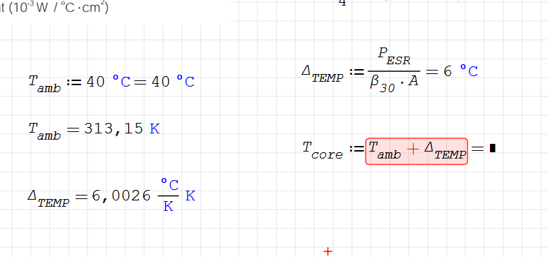

#8 Опубликовано: 28.09.2019 19:17:24
Juan Manuel
Juan Manuel
0 сообщений из 14 понравились пользователям.
Hello, I would like to consult you
                                                I define a temperature in degrees Centigrade, when I call it it looks like Kelvin degrees and then I can't make a sum because it tells me they are two different units. How can I do so that the defined temperature is maintained in every calculation in the unit that defined it?
Attached image capture of the problem.
Thank you

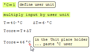

#9 Опубликовано: 29.09.2019 04:22:37
There are many posts on the Forum about handling tempereture units. See for example this one.
frapuano 29.09.2019 08:28:00

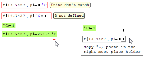

#10 Опубликовано: 29.09.2019 07:46:27
Smath Unit System is ISO, °C is not ISO.
Define your user unit.
If user unit is not '1', don't multiply input by user.

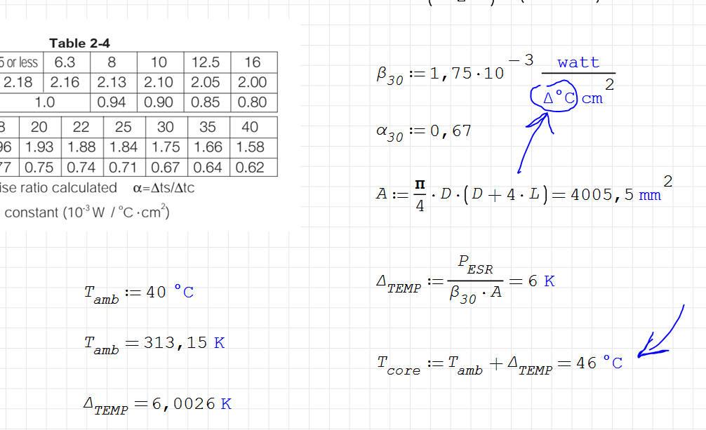

#11 Опубликовано: 29.09.2019 09:37:54
Visit Colebrook, suggestive how to carry Engineering projects.
And recover units in the results. Each project is specific.
Please, feel free to attach your project for more doctoring.
Inst_Colebrook Pipe Data.sm (61,76 КиБ) скачан 1153 раз(а).
